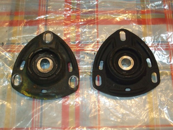

See attached photo - spot the bad mounting!
Previous owner had some suspension work done, and the mechanic didn't bother tightening the top nut. Car was amazing to drive - it could change lane with no warning, and before you could work out what had happened, it could change back again. PO also had it fitted with 255/40/17 tyres, and the roads round here aren't great. It's now on 225/50/16 and ever so nice to drive.
That car also had a badly worn tie rod - both outer and inner ends, and a worn track arm (outer ball joint and inner bushing) - all on the same side! If I can find the bits, I'll photo them so Dave can add them to his collection!
Paul

Originally Posted by Paul Heneghan
See attached photo - spot the bad mounting!..If I can find the bits, I'll photo them so Dave can add them to his collection! Paul
Paul: Too funny. I see your photo and go OOooo!! OOoo!! Good photo. Must save. (But it does look a bit familiar). Anyway, I right click on the photo and do SAVE AS, find my UrS Front Suspension photo folder and, sure enough, I have previously saved your photo and probably incorporated it into a front suspension post. So thanks. (I'll go find that post and update it with a "Courtesy of Paul Heneghan" notation.
Keep the photos coming.
Dave F.
