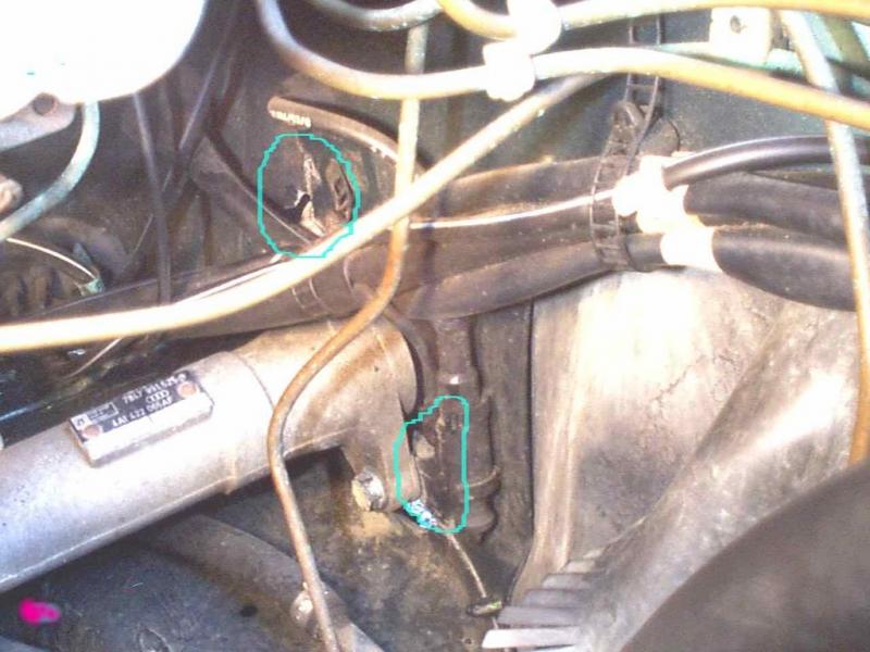

Found this on the old laptop -

Thanks for posting the photo. Too bad you could find a larger version of the other one.
