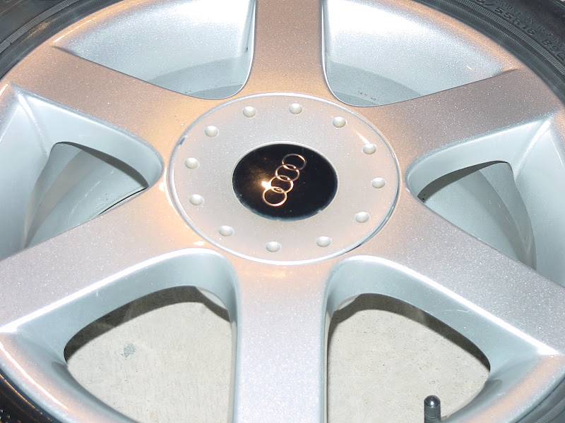

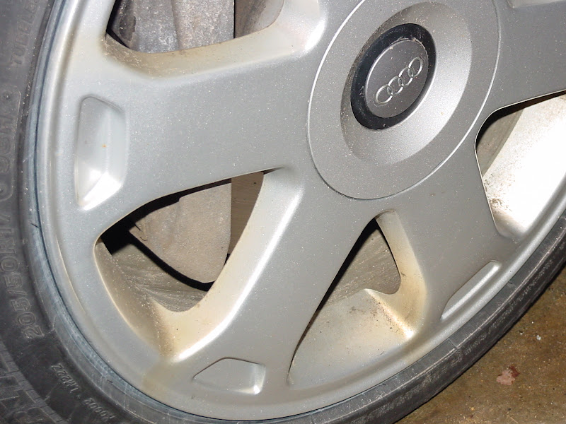

This past winter has left 'Bahn Burners A4 wheels with the worst staining/yellowing I have ever seen! The A4's "Tango" 6 spoke wheels, which I picked up 2+ years ago for winter use have seen 3 NH winters and about 23K miles. They came off the A4 yesterday for Summer, and I wanted to get them stored away with a quickness. Last year they were almost as bad in the Spring and I would rather forget about how much elbow grease it took to get the filth off! I am not talking about brake dust filth either, I'm talking about glued to the clearcoat-rust like stained on filth.
I don't have a before shot of this years devistation on the Tango's (I did a test run with <b>Kaboom</b>, and just got carried away with the cleaning when I realized it was working), but here is a current shot of my S4 Avus wheels.
<img src="http://lh6.google.com/bahnburner/R9F2Synhz2I/AAAAAAAAAVc/zI1-Gc2ZCFY/s800/DSC04191.JPG">
You can kind of get an idea of the staining/yellowing I'm talking about, but these are NOWHERE near the level of filth that the Tangos succumbed to.

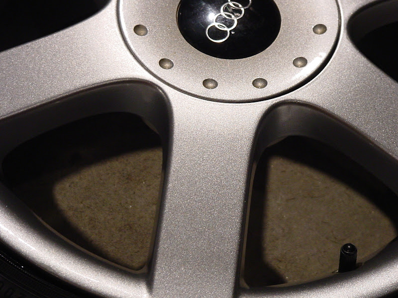

Onto the results...After a small test run, which immediately showed great results, I sprayed <b>KABOOM</b> onto all of the rim surfaces and let it soak on for a good 15 minutes in the cool calm misty night here in NH. I then took my wheel sponge and wiped away the staining quite easily. The nooks &amp; crannys were a little tough, but I just re-applied more <b>KABOOM</B> and the filth melted away. I then rinsed off the wheels with hardly any suds forming. The product description was right on the money, absolutely no residue left after rinsing with water. Here are some pics after wiping them down only, no polishing or waxing applied. The clearcoat is still intact and feels smooooth! ;-)
<img src="http://lh5.google.com/bahnburner/R9F2Sinhz1I/AAAAAAAAAVU/gdpVLna6rKM/s800/DSC04190.JPG">
The Tango wheel pictured was the worst of the batch (from the front right on the car), so you can imagine how delighted I am with the results. =)
