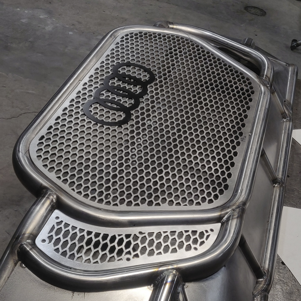

Much like autocross, drivers in ice autocross have a tendency of taking their build to extremes. And while you may have already noticed this car’s porcupine tires, we’re mostly interested in what’s going on with that new fascia.
ICE6 Audi S6
Snowbanks are filled with ice chunks, despite snow itself being soft. Plus, orange cones are rock hard in frigid temperatures. Plastic bumper covers have a tendency to break in these conditions, but metal sure won’t. Vechar described the build as “unique and challenging.” That’s an understatement considering it is a 4-piece build, that utilizes a new front grille section, the entire front bumper section, a skid plate, and fenders.
Best part of all? This setup installs in factory mounting points, and can revert back to stock.
Materials used include 1.5 inch, 11 gauge DOM tubing for the structure. The bumper itself utilized 7 gauge sheet metal, and the fenders used 16 gauge sheet. We’re most impressed by the precision, the ability to work around existing components within the bumper, and also keep all of the Audi styling cues as part of the build. Speaking of which, the “ICE6” integration into the fender is seriously cool.
