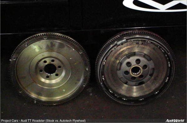

The final part of the clutch assembly was maybe the toughest choice of them all: the flywheel. There is so much information, both good and bad, on lightened flywheels that we were quickly overwhelmed in our research. Sorting through reviews, websites, product information and visiting with other enthusiasts, we affirmed a few things about installing a lightened flywheel. Basically we expected to experience a very fast revving motor that was quick to respond when the hammer was let down due to the lower rotational mass. We decided to go with Autotech's lightened flywheels for a couple of reasons. First, we had been warned about buying flywheels that are simply stock cast units that are then machined to lighten them. Because of the varying qualities of the castings, sometimes the machining process can really degrade the strength of the unit causing stress fractures and eventual failure. The Autotech flywheel is a cast steel unit that is then CNC machined for an exact balance and lightening. We wanted to have the most durable setup possible so this seemed like the best match.
