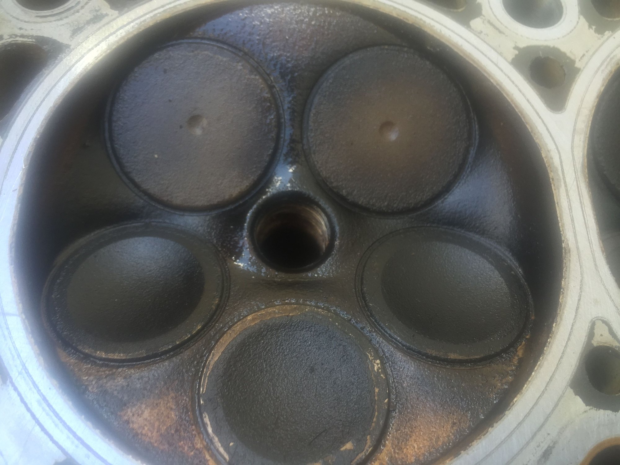

Im had to double check and make sure I didn't write this one. Exact same thing happened to me with the cam being off one link and turned it in and know immediately something was wrong and turned it off. Purchased another cylinder head with cam and chain tensioner all included and installed. My problem is I also purchased the timing placement bar so I can achieve TDC but how in the heck should the head and all that's part of it supposed to be positioned once I get er on?

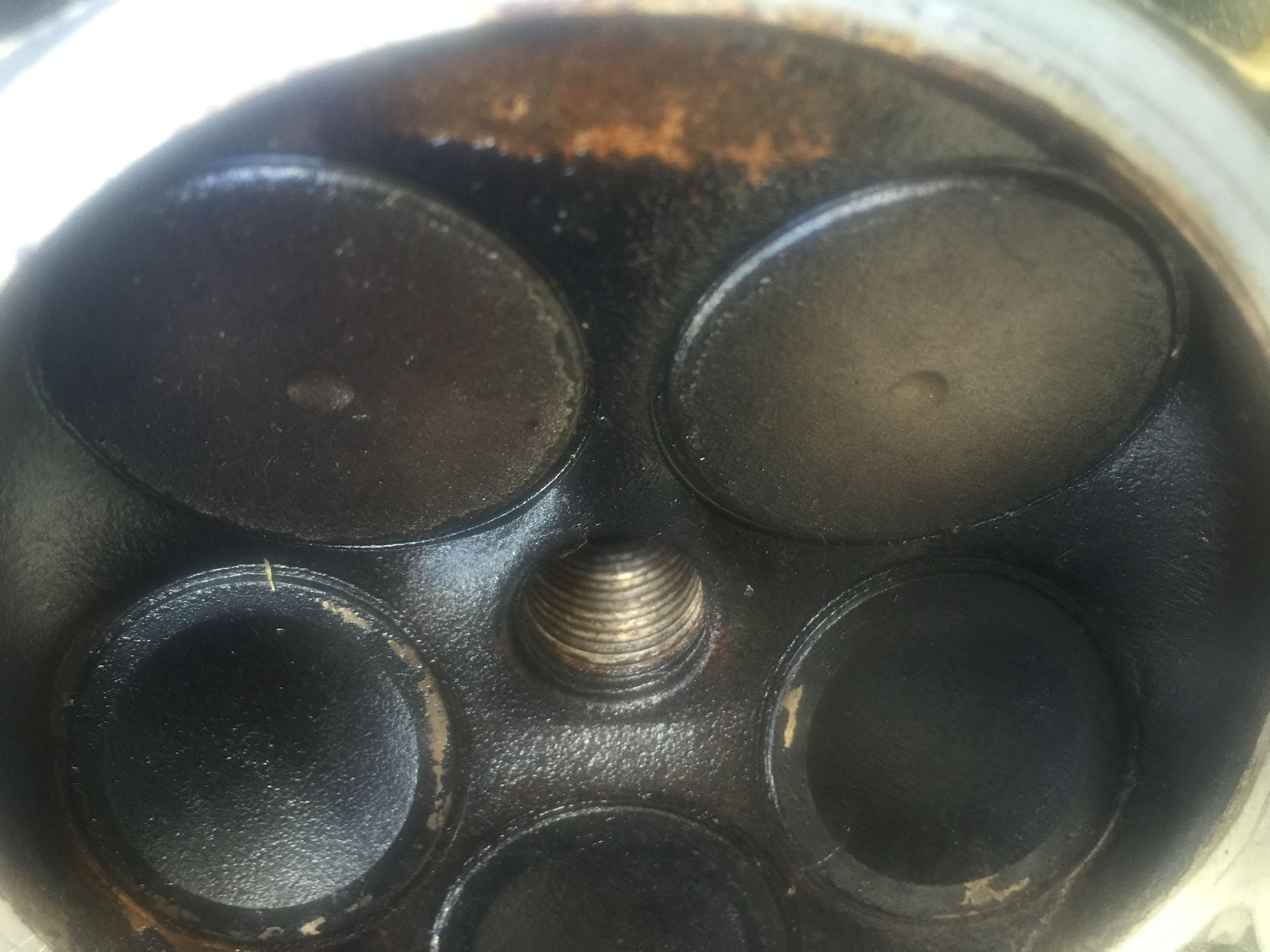

Bottom of head. They look pretty bad but unsure what to clean them with. Break cleaner?

You should take all the valves out, and lap them to make sure they have good sealing surfaces, and then throw new valve seals in. If you take your time and go a good job, you should have a nice set of freshened up heads. With 30 valves, it should take ~2hr to get them lapped and new seals in. Definitely worth it. As for cleaning all that carbon off? Go to harbor freight and buy a wire wheel drill bit, and run it around the combustion chamber, periodically spraying carb cleaner.
