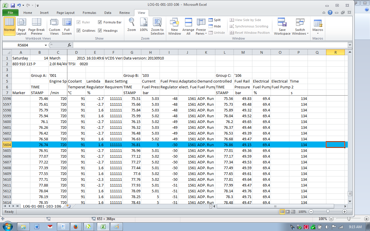

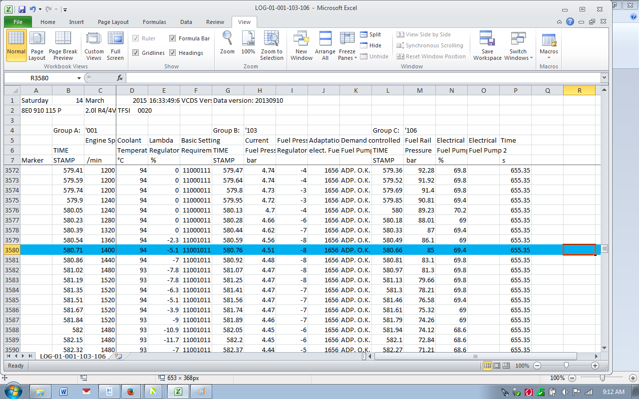

Hi chapstick,
ok i will try that later and send you the data then.
Also I went into the measuring block section and this is the result
at idle with 840 rpm the fuel rail pressure is 49.5 bar and the electric fuel pump is a 82.4 %

You can log three at a time(as opposed to 12 in "advanced measuring values") from the engine measuring block window - always use turbo mode to get a more seamless log.
Throttle 3600 rpm ***pay no attention to the lambda regulator % this was taken while I had a vacuum leak. Lambda regulator resets every time you clear codes in the engine control module. The lambda regulator should stay under +/-five to be normal and can get as high as +/-15 I believe(don't quote me). That's when you got problems. Ideally it should float 0 to +/-1***
Throttle 1400rpm
Idle
I'm not sure that the lpfp is definitely the problem. It does look like it's dying, but your current fuel pressure looks decent from what you said.
So get the data log with all the good stuff twelve at a time like I said earlier and look for fuel cuts/irregularities vs. specified. Also get the misfires in cylinders as well. This may take you several runs with several different combination of values to get anything remarkable. Too early to rule out a bunch of stuff.
cam follower needs to be checked & hpfp plunger, lpfp and maybe even the fuel filter for all we know right now. Hope some good logging is more revealing.
