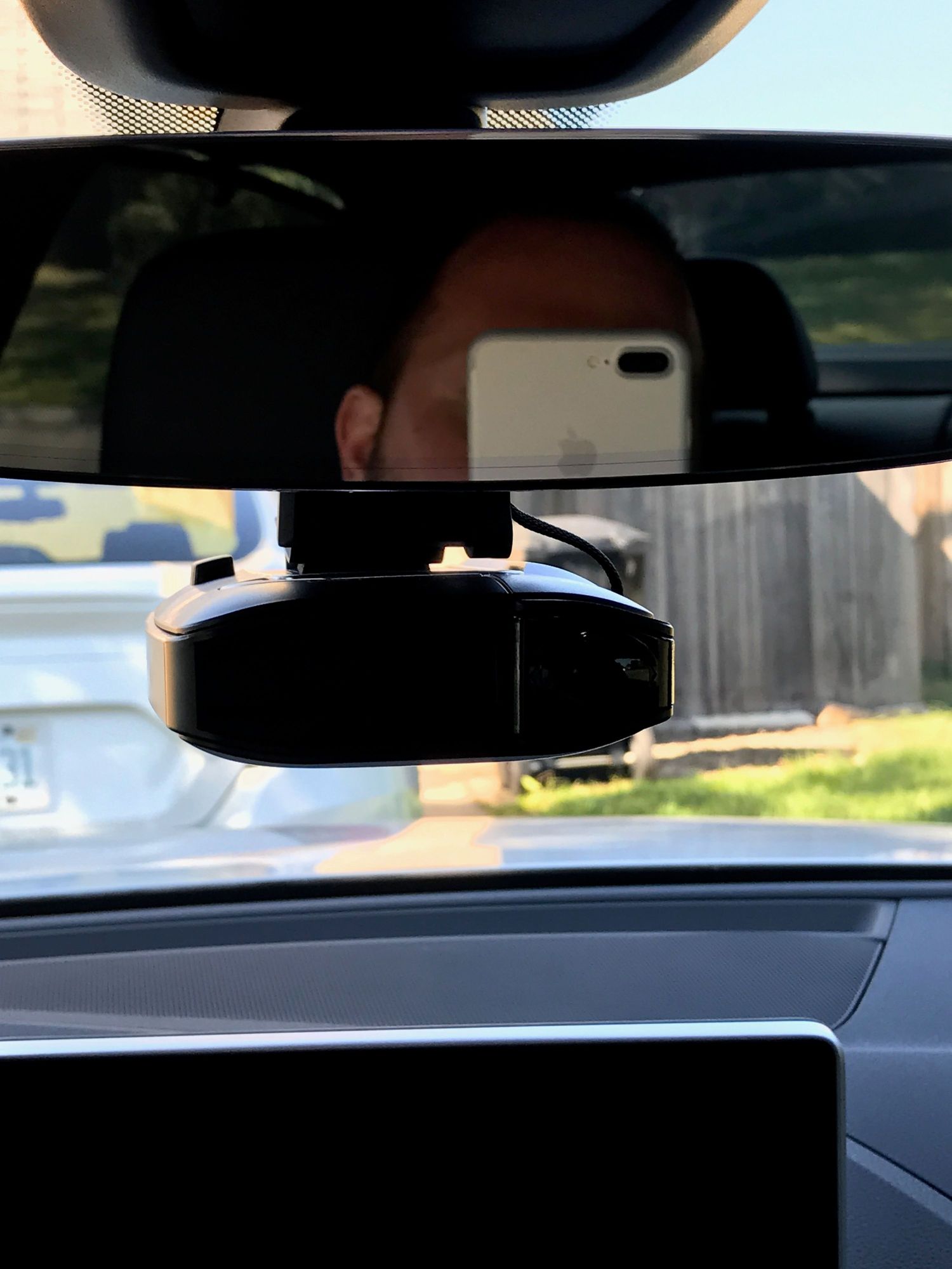

All I thought I would share my very clean install of an Escort Max 360 using BlendMount and MirrorTap on my 2017 A4. The install was fairly straightforward; remove some trimming, tap into the yellow and brown wires in the mirror harness (Red to yellow and black to brown), clean up cabling and adjust mount so level. (Thanks to some help from this forum with other postings from @LarryV / @Magnit and others.)
Everything looks great and is rock solid with very minimal vibration vs. window suction mount. One oddity I have found is acquiring a GPS lock on the detector, it appears the mount/positioning under the mirror causes issues, when I remove and manually hold to window and/or use suction it acquires GPS very quickly. Has anyone else used a blendmount and seen similar issues in their A4, specifically with this detector or others?

Since my initial install, I have contacted BlendMount about my GPS issue and they sent me a modified mount to test using a C7 Corvette arm to push out the detector further from under the mirror, and this is showing as a promising fix after two days of testing. Kudos to them for willing to send me another arm to test with. I'll post pictures shortly of the new setup.
