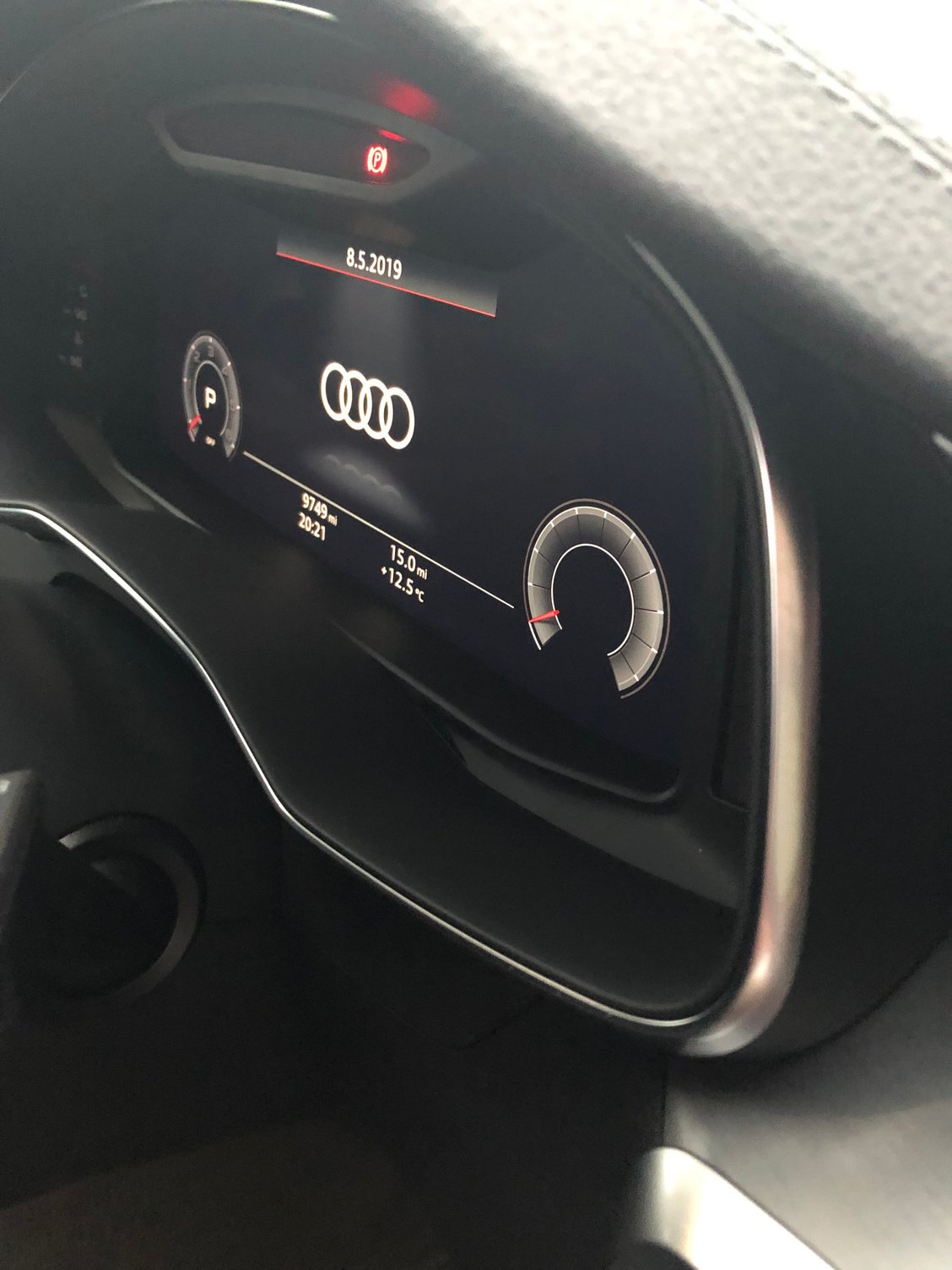

Originally Posted by RobGO
Surround causing rattle
Found out that my rattle was coming from the silver surround attached to the virtual cockpit display. Dealer stripped the dash and put in extra padding. No more rattles for the time being. Few pics of car attached
Very nice. I’ve noticed a slight vibration (only on occasion) at this spot too. Thought it was in the steering column somewhere, bc the silver trim felt fairly solid to the touch. Will have to check it out again. Was this an easy trim to remove?
Dealer said that it was a bit of a job to remove most of the top of the dash to get at the problem, lots of clips etc, but fingers crossed it seems to have worked.
Oh Ok. Thought it would be much easier just getting at it directly from the front. Thanks.
