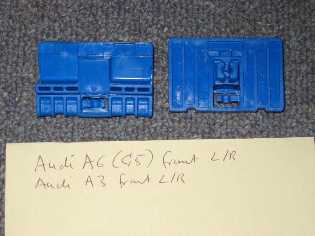

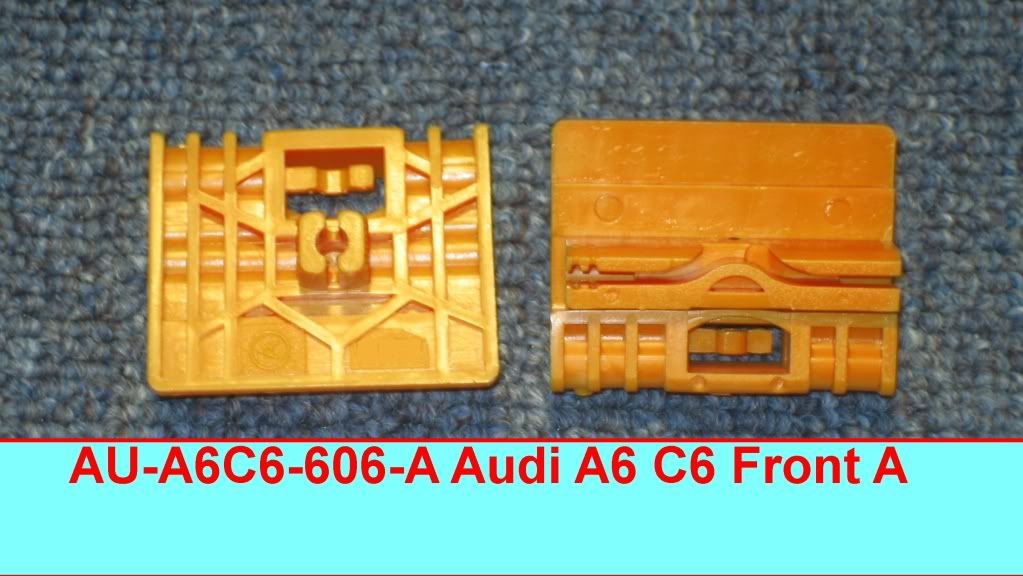

Can someone check for me which of the clips below (disregard the color, can be anything) fits the front windows of the C6 models?
Here an example of the regulator:
http://rachenggong.en.alibaba.com/vi..._B7_O_E_NO.jpg
Here is one version (I call it the 3+2 ribs; note the number of ribs in this unsymmetric version, one clip 3+2 the other 2+3):
This is the 'symmetric' version (3+3 ribs, both clips the same (fits C5 models):
vtraudt is offline

Could it be that one is Left door & the other Right door?
Does this help? -

Figured it out: its a pair of the (3+2, 2+3) clips in each front window.
In stock. Ditto the large clip for the C6 rear windows.
Now just need to figure out what is used in the rear of the C5.
Maybe the C6 clip fits?
