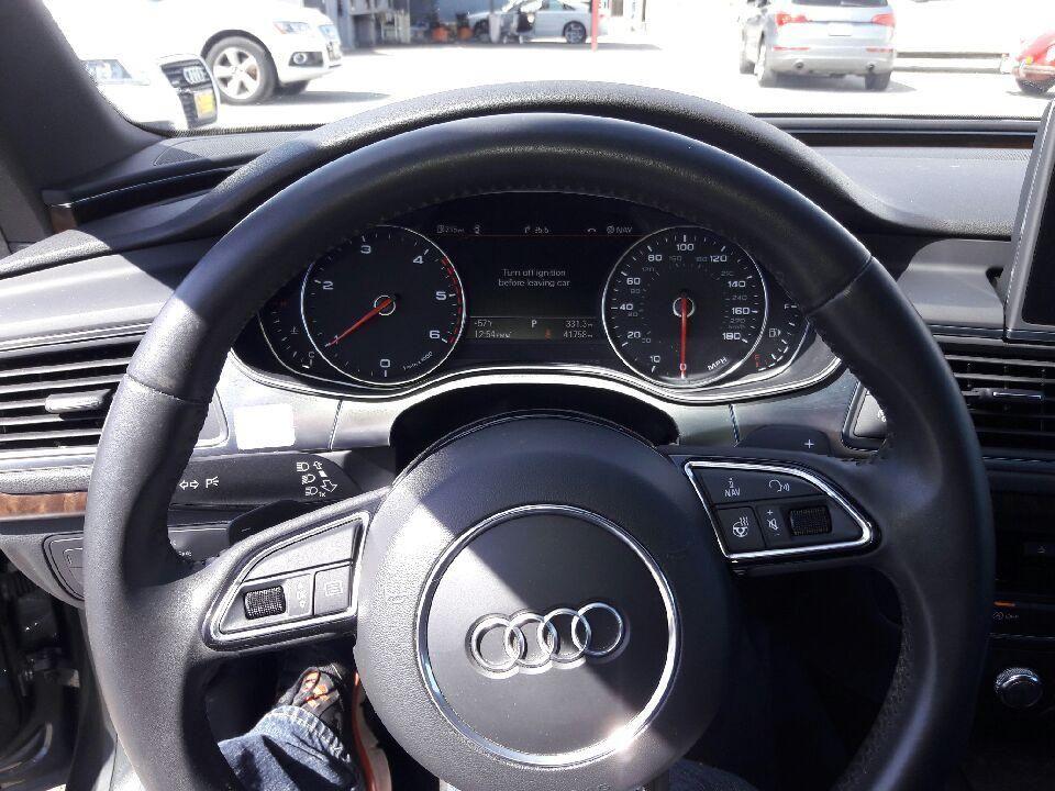

Here's our upcoming '14 A7 TDI wheel (grainy cell phone/text image, not all beat up, lol):

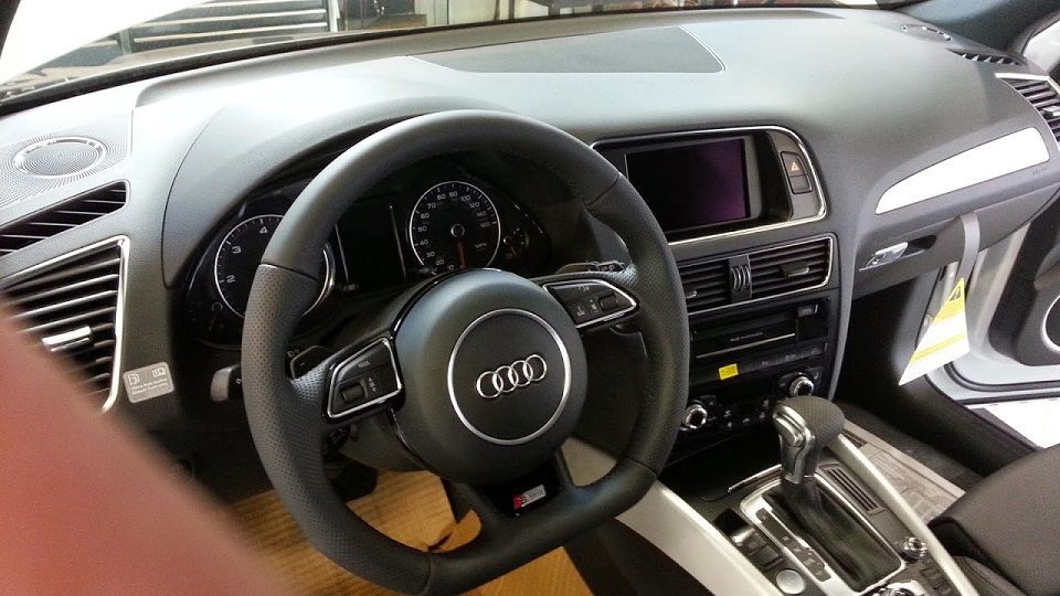

Here's the wheel in our TTRS (full air leather):
And here's in our Q5 TDI S-Line (partial air leather):

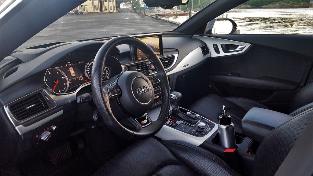

PS - I found this photo in the gallery thread which looks like what I'm describing, though I'm not sure on the heating aspect. Also it's from Norway (2011 TDI S-Line) so not sure how parts match up. So if something like this exists as an option for US steering wheel swap, please share details! Thanks
