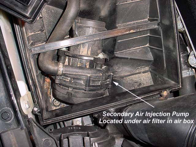

I used this as a guide >>
quattroworld.com Forums: Behind and below the junction of the y-pipe...
In A8's the pump is in the bottom of the air cleaner box.

Thanks. Is this the location as in a picture?
