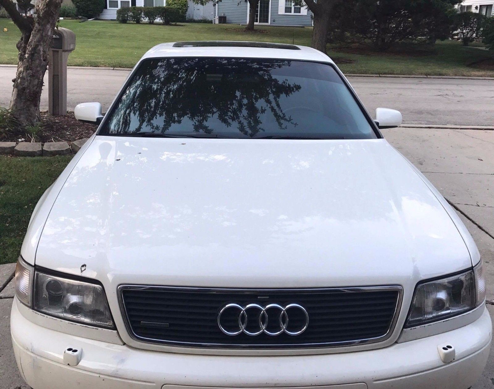

Hello all,
I just recently got back into the Audi world after a long hiatus due to the sale of my 1993 S4, with the purchase of a 1999 A8.
I am looking for a set of caps for the headlight washers, does anyone know someone/somewhere that I can find a set? Painted or not isn't an issue, just would like to fill these holes.

Although they are called "cover caps", they're actually exposed spray nozzles (see pic below of 99 A8).
2000 and up (Facelift) have flush mount pop-up nozzles.

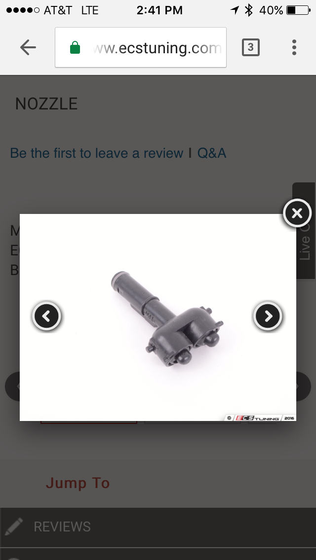

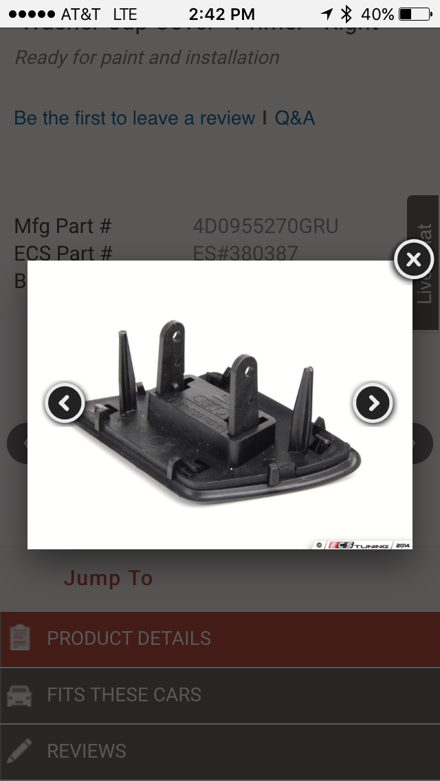

So what is actually holding a cap attached to the bumper on facelift cars?
Some kind of spring or?part number?
Could not figure it out so i glued it but it fell off.

https://youtu.be/Lb04W8YGJQE
I think i figured it out.I have this spray nozzle missing from my passenger side.These 2 little pins on the side of the sprayer are holding the cap.
