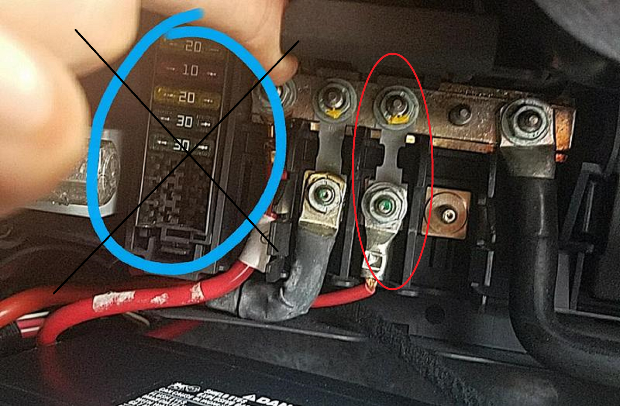

Can you take the picture of the battery in the bay with all cables connected? And the voltage ?

Looks good, how old is the scan? What's the voltage across the terminals and the ground pole? Do you have a DVM?

Originally Posted by tony51;25260668
[img
https://cimg3.ibsrv.net/gimg/www.audiworld.com-vbulletin/2000x1124/20190111_183142_5bc931063970d4e32a4b57decfa7caf89e 489eb6.jpg[/img]
Did you check the fuses under the flap?
