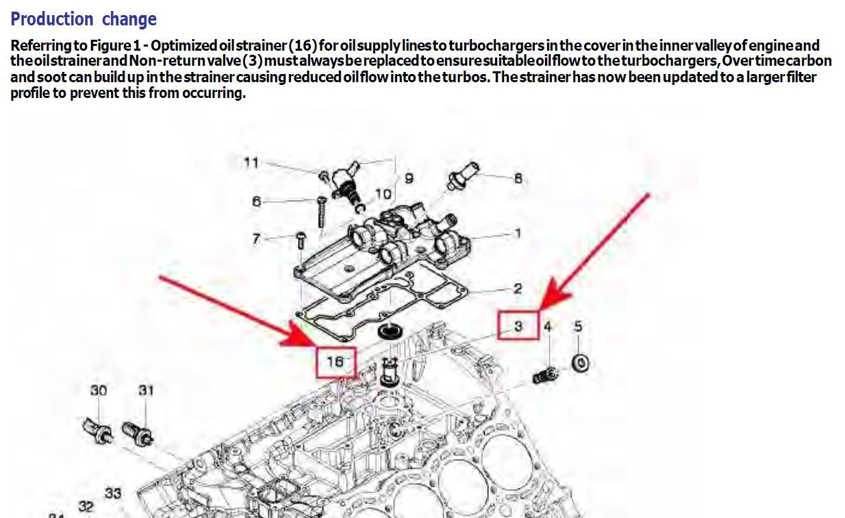

So far there are 52 4.0T failures posted on the C7 4.0T Audi Az Poll. It is not just an issue with D4 platform. The Audi 4.0T failure is in all the VAG 4.0T applications of that engine: 2013-2017 Audi A8, S8, S6, S7, RS6, RS7, 2012-2018 Bentley Continental Series and Flying Spur equipped with V8 4.0T engine.
From Benley TSB:

Would it be correct to interpret the above TSB to conclude that 2017 models with higher VIN numbers than noted, as well as 2018 models, have been manufactured with the larger filter profile? I hope so! Mike
Yes. I don't have any special knowledge of running production changes they made, but that is how I read this TSB--especially when they are specific by VIN within MY2017.
