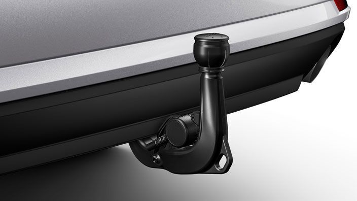

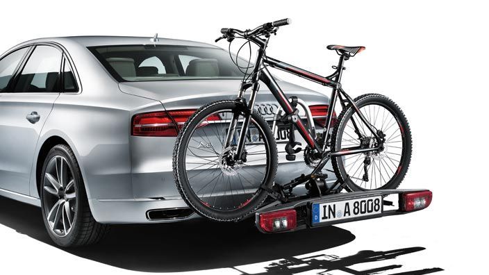

Can't you go the European route and get a ball hitch and a rack that clamps on to it?
https://shops.audi.com/en_GB/web/zub...rear-transport

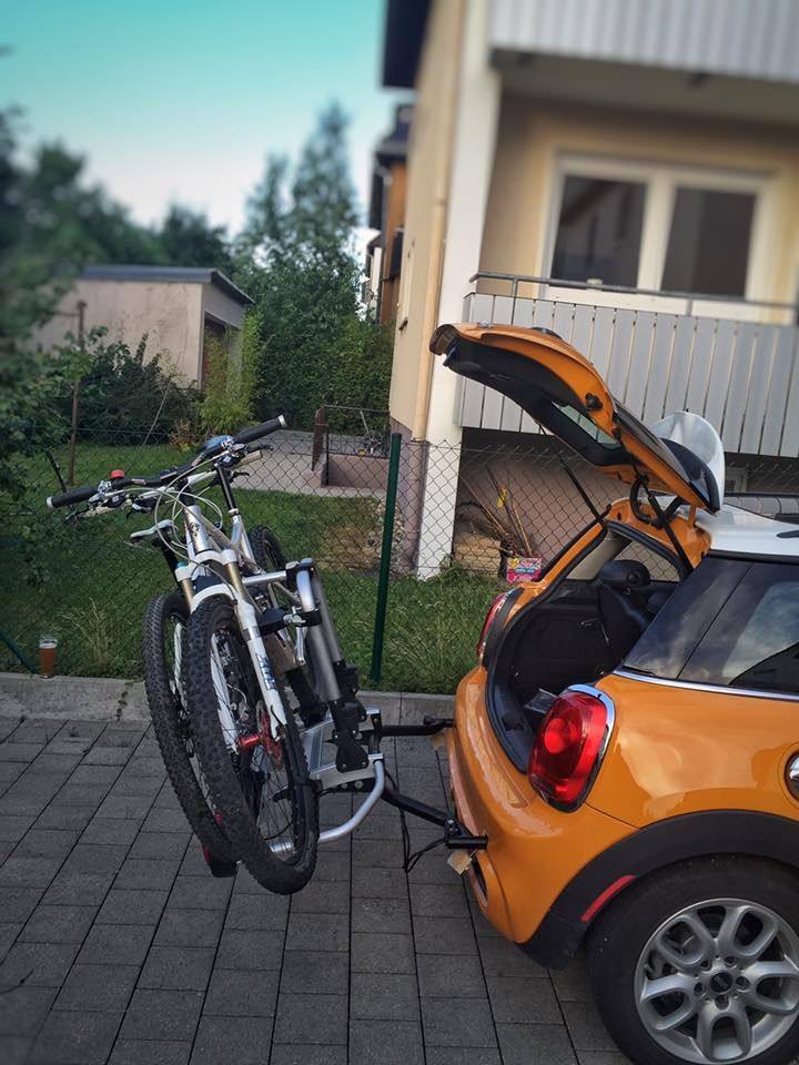

Although it would be better if Audi made a hitch like the one I bought for my wife's MINI that connects to the frame via the tow hook threads in the bumper:

I haven't been able to get confirmation that the OE hitch is compatible with the S4. I checked with my dealer and their parts department and was unable to get confirmation. Plus I already have a standard hitch bike rack.

I am almost positive it is since this is how Audi owners in DE rack their whips.
But, the Euro option is a no-go in your case, as it sounds like you have a reciever hitch bike rack. I'd think it would extend too far past the rear bumper and scraping on the pavement on dips as one exits/enters parking lots etc.

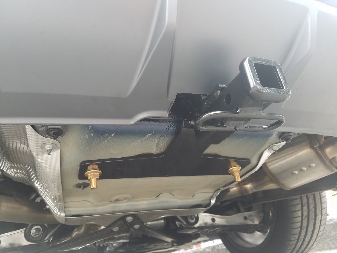

I just added the Curt hitch which apparently is the A4 hitch but fits the A5/S5 perfectly.
you do have to cut a small bit of the bumper valence underneath. I hope it won't get noticed on vehicle turn in at lease end, would be surprised, but if i do a precheck a month early, i can have it replaced cheaply at that point, as it is a separate valence and not the entire bumper.
I will have the gold bolts you see extending down, trimmed as well.
the Curt part is here - CURT Manufacturing - CURT Class 1 Trailer Hitch #11448
this was speced for a 2018 A5 Coupe per curt, but fit perfectly on my 2018 S5 Cabrio.
I had the work done by my classic car shop who works on my old Tr6
