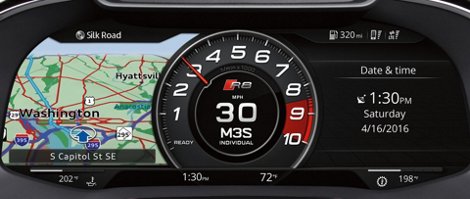

Yes, it does. M carries forward the current engine/transmission mode in particular the throttle map. In S a more dynamic/sporty throttle map is used, so if you do S -> M vs D -> M you'll have different throttle maps. The shift speeds are affected, too and how aggressive it engages the torque lockup clutch. For some reason Audi refuses to indicate in the dash that there are really two manual modes. They only do it for the R8 as you can see in the following picture where it indicates M3S, so you know that you are actually in the sport manual mode.
i did did not know this.
Thank you sir! 👍🏽
