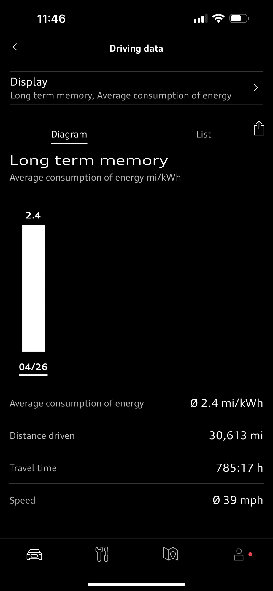

Originally Posted by coldrain85
How in the hell are you folks getting this kind of efficiency? My 2022 is pretty much always in the 2.0-2.3 mi/kWh range unless I'm driving downhill. And, no, I don't drive fast with the AC set at 60 degrees.
I never get the advertised 222 miles of range. Never.
There are times in 80dF clear weather when I can get 2.8-3.0 m/kWhr on my 22 mile drive to work; average speed about 54 mph, (congestion), with the cruise set at 9 mph over the speed limit which on the highway varies from 60-65 mph; Efficiency mode; 21” wheels; tyre psi set to recommended pressures.
Long term efficiency since I bought the car over 30,000 miles is 2.4 miles/kWhr over 3+ years and some very cold winter months.
