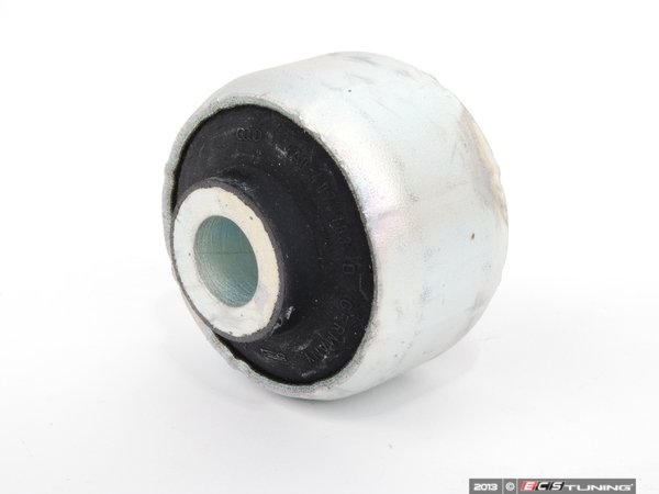

lower front control arm bushings can they be replaced
In theory, yes. However, the usual mode of lower control arm (LCA) failure is the ball joint at the outer end, not the bushing at the inner end, unless of course somebody forgot to install the item 10 sleeve. The bushing on its own is Item 3, PN 4A0407183D
Online Audi 100/Avant quattro spare parts catalogue, Europe market, 1993 model year: front axle, steering group, suspension, wishbone, wheel hub, anti-roll bar subgroup, Audi VIN decoder, aftermarket, etka online
https://www.ecstuning.com/b-genuine-...ch/4a0407183d/
