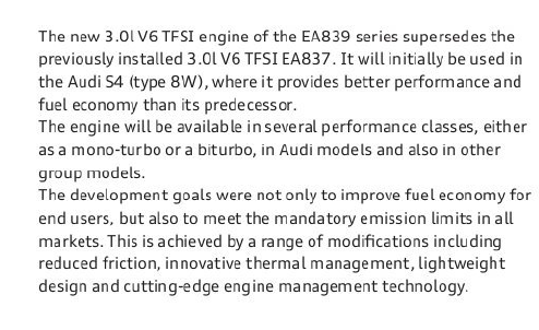

It's not the E838 engine, it's the EA839 engine.
You are wrong. The EA839 is the 2.9 litre engine. Don't bother checking back on the draft erWin (USA version) self-study guide you posted last year, that is wrong too. I didn't bother correcting you then, but I will now.

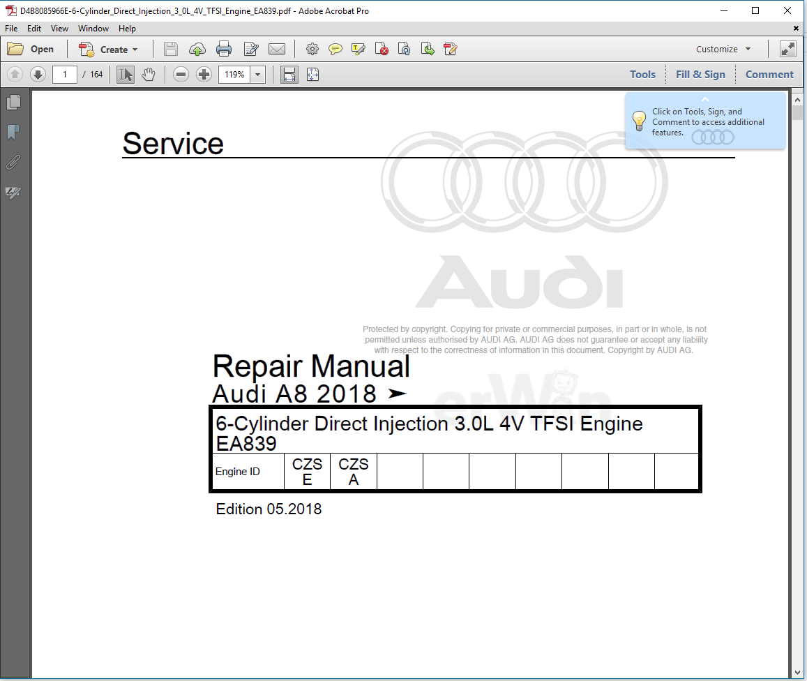

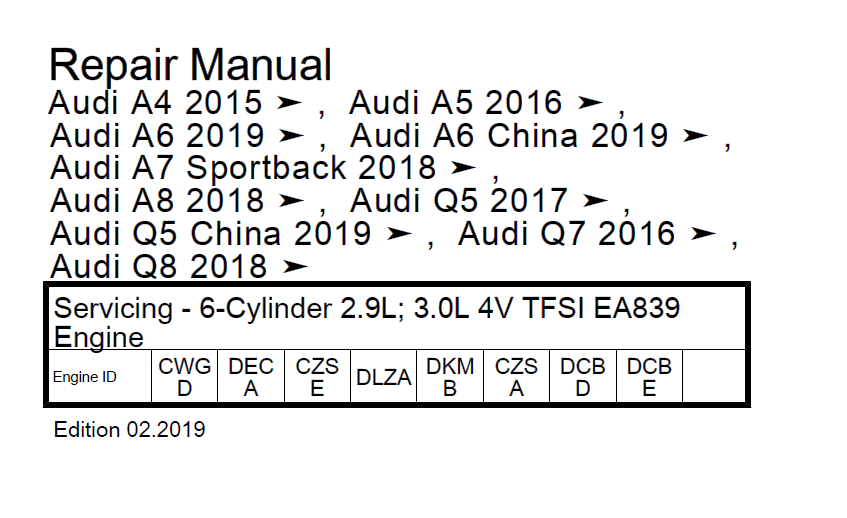

You clearly need to do more research, and before you allege I'm wrong, I've gone through almost every single technical memo there is on erWin.
From Erwin, effective FEB 2019.
And another:
If you're going to call someone out, you a) better be right and b) you better have proof rather than using words. There's mine. Where's yours?
