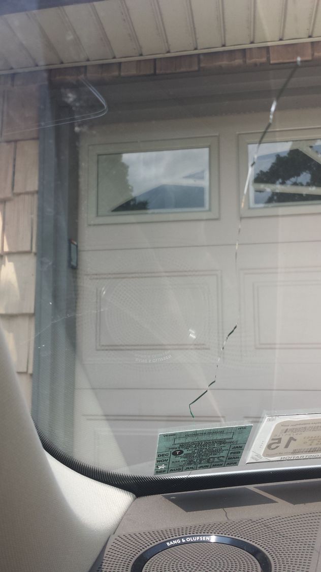

Here are some pictures. Not easy to see, but this is the best I could do with smartphone.
The rock hit was about 1/3 way up from bottom of windshield and that NYS inspection sticker (square one).
FWIW.

If you don't mind take a pic of the Windsheild logo information. I know glass, in particular automotive laminated safety glass. The thickness doesn't have much to do with its resistance to stone impacts. The internal stress and tension/compression profile is most important. The thickness actually is more geared towards sound dampening, acoustic vinyl does a better job damping but can't attenuate all frequencies, hence thicker glass. But thick glass is expensive and heavy! Thin glass with acoustic vinyl is best setup IMO.
Typically the perimeter of laminated glass is the weakest part of the windshield. The region 8-15mm from edge of glass. Stress can also be high up to 400mm inboard from edge depending on their annealing and tooling setup. The cermaic area is usually weaker too due to the emissity of the surface, ceramic area heats and cools quicker compared to the clear area. The center of glass, in the normal viewing window typically has no stress and can withstand impacts much better.. You can see stress with polarized glasses. It looks like this. Cool huh?
I can tell you there is no gaurantee a WS can withstand stone impact, especially where the rock hit your windhsield, in the ceramic print area near the edge. I see a big dig mark, glass chip.
I would try the Saint Gobain (france) if others report the same issue with Gaurdian. Staint Gobain may make a better windshield.
How does distortion look? Do you see waviness around the border dots or mirror/rain sensor area? Feel free to ask away.

Thank you for your comments and insight. I will get photos of the label on both the old and new windshield (still at Safelite). Perhaps the Saint Gobain would be better.
