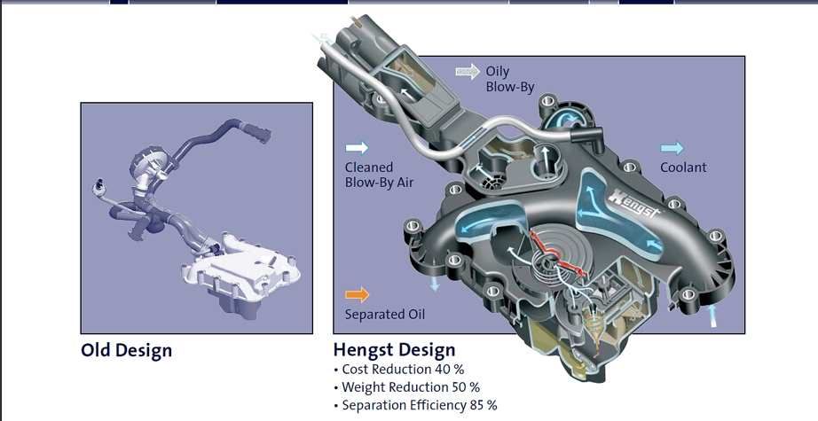

They have updated and improved the vapor separators over time:
High-performance technology - precision engineering in a confined space
For Audi A6 engines
Compact modular technology reduces operating costs. Connecting lines, couplings, gaskets and fasteners can be eliminated. High performance in a small space: A machine-made crankcase cover made of plastic (basic module), free-form channels for coolant distribution, a smaller pressure control valve, crankcase ventilation oil mist separation with multicyclone and pressure regulating valve and increased efficiency cal all be achieved by material substitution and intelligent process technology.
The coolant distribution channels are designed with large cross sections, smooth interior walls and fast design-to-production times using new 3D technology. The plastic used withstands even the demanding temperature conditions during ventilation with peaks up to 160°C. Because of its advanced projection capabilities, the smaller pressure control valve can be protected against freezing by placing it directly on the coolant line. The effective oil mist separation is accomplished with a patented latest-generation multicyclone with pressure regulating valve.
For Audi A6 engines
