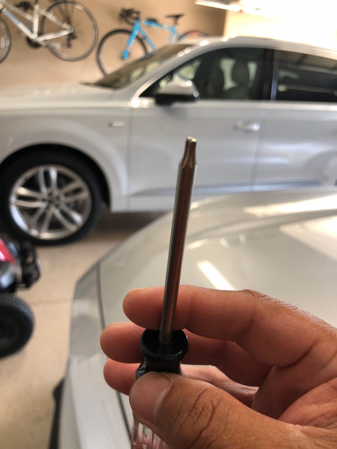

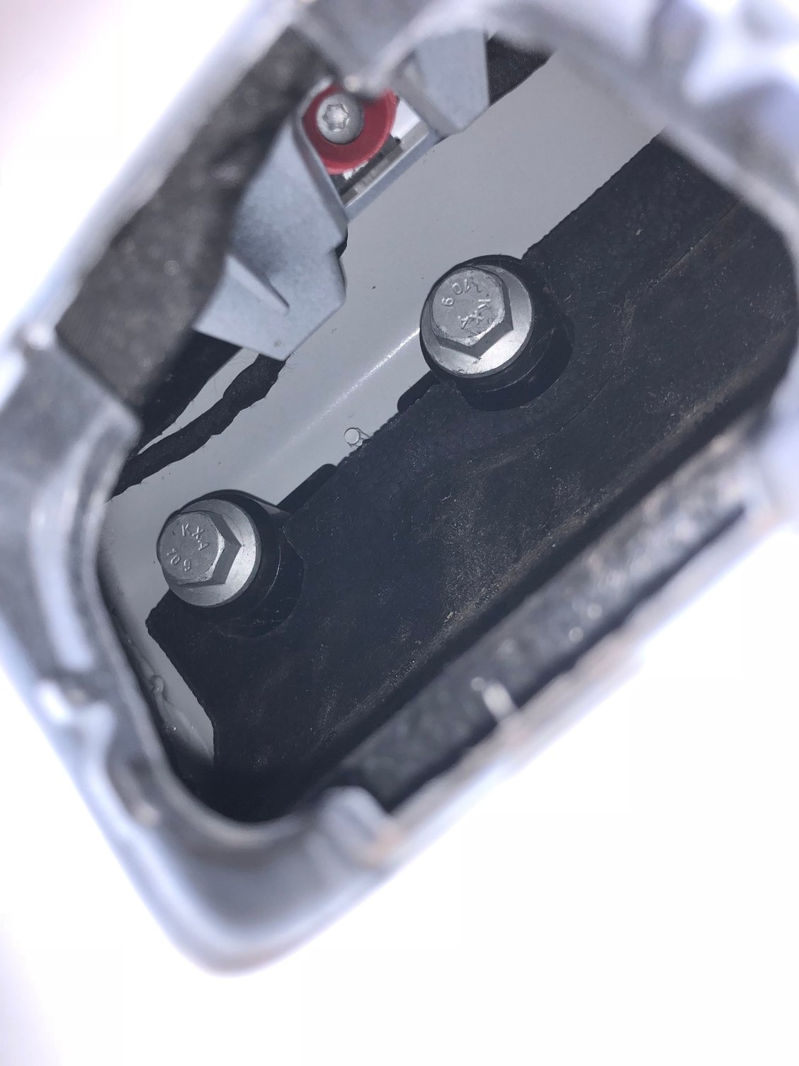

Its easy to replace it. Pop the small plastic cover on rear bumper. Look inside of it to see the screw. Use Torq screwdriver to loosen it. Then push the lights out.
