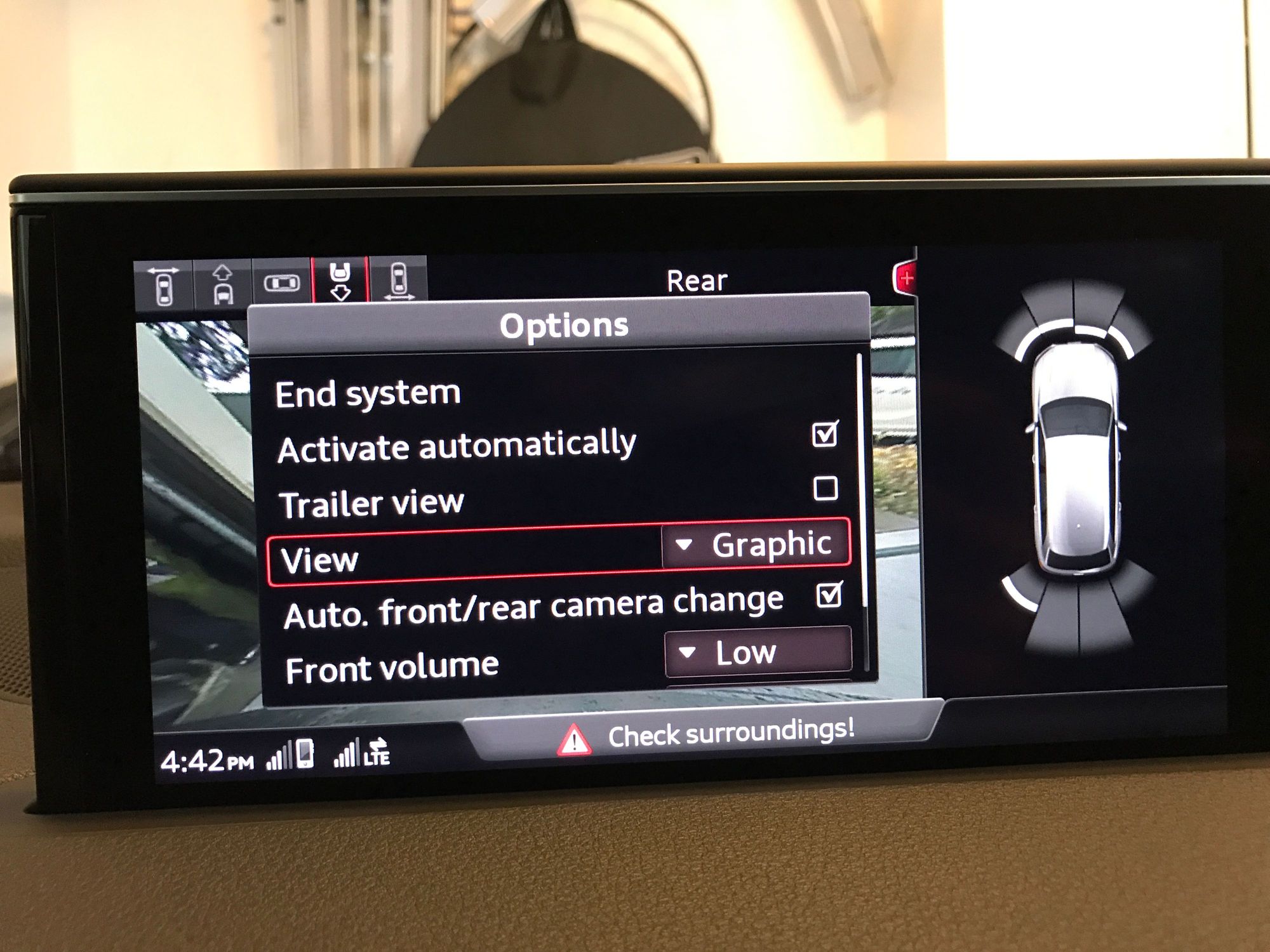

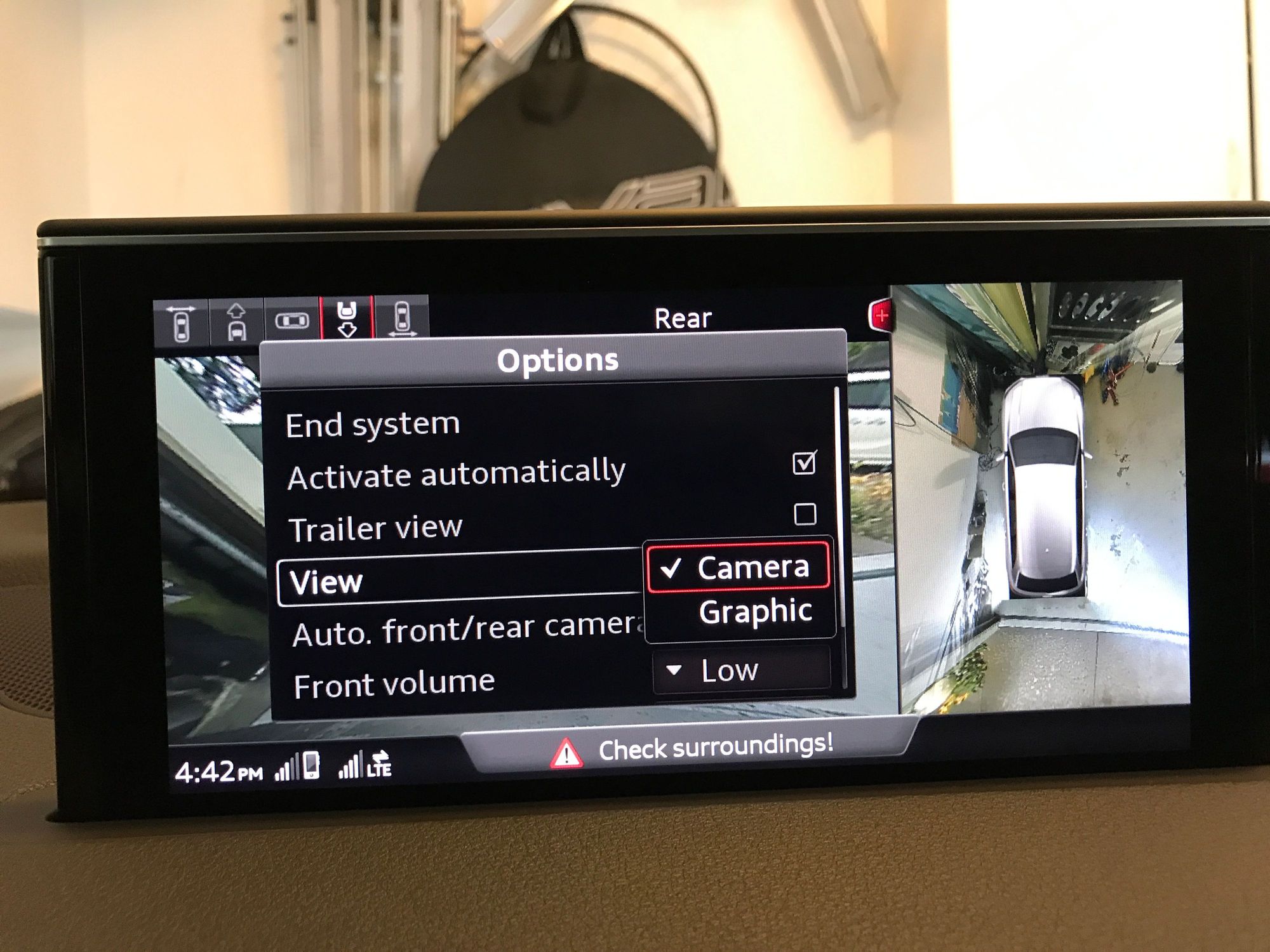

I just took delivery of a 2018 Q7 Prestige a few days ago (replaced a '12 Q7 TDI that got bought back &#129297 and have a question about the parking aid. It's cool to have the camera view on the right side of the MMI. I selected that option in the MMI, and it holds that setting for a little while, but after the car sits a while and is restarted, it goes back to the "Graphic" view.
I'm talking about the view on the right side, like this:
That overhead, camera-based view is selected here:
But after a restart, it goes back to "graphic":
Is that normal? Is there a way to make it stick? I do have VCDS so can change something there if needed, but I am a rookie with that so I have no idea what to do unless someone gives the exact coding to input.
No, thats not normal. It should stay as "Camera" once selected.

This has just been sent to me from Audi in Germany:
"This concern is being investigated and will involve a SW update to correct. This concern occurs when the automatic Park Distance Control is activated and the forward view is displayed, (always a graphic view on right side of MMI) and then the vehicle being shut off. After a sleep cycle, the MMI stores the graphic view in memory. This also causes the setting in the MMI to change from camera to graphic view. To avoid this from happening, the customer would have to select reverse gear before shutting off the vehicle to force the overhead camera view to be displayed and incidentally stored in memory each time the vehicle is shut off during a PDC event. Make sure the setting in the MMI is set to camera before releasing the vehicle and advise the customer of the current operation and how to avoid the concern."
Audi advises there is no current time line for the SW solution for this concern at this time. Software can take 6 months or more to develop and release.
I'm going to try what they suggest now that they've described what the bug is and how it is triggered.
