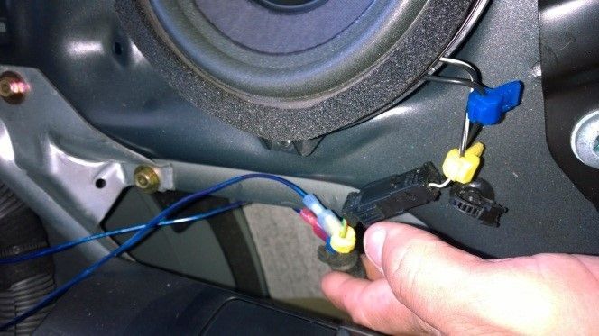

I just bought an Alpine mono amp and i have 2-10" Rockford Fosgate subs in a box i would like to add to my TT. What wire do i tap into to run to the Alpine Amp? Been searching for 3 days now. I have the Concert Stereo CD/CD changer with Bose. I did find out the Bose Amp placement is in the Driverside 1/4 panel. I have some time this weekend to do the install.
Please help.
Thanks in Advance.

i t-tapped into the wires that lead to the driver side sub speaker and then ran the wire to the amp. important to tap into the wires before the small black connector.
just above my thumb is the black connector. the blue wires running to the amp are connected to the driver side sub speaker wires before the black connector.
