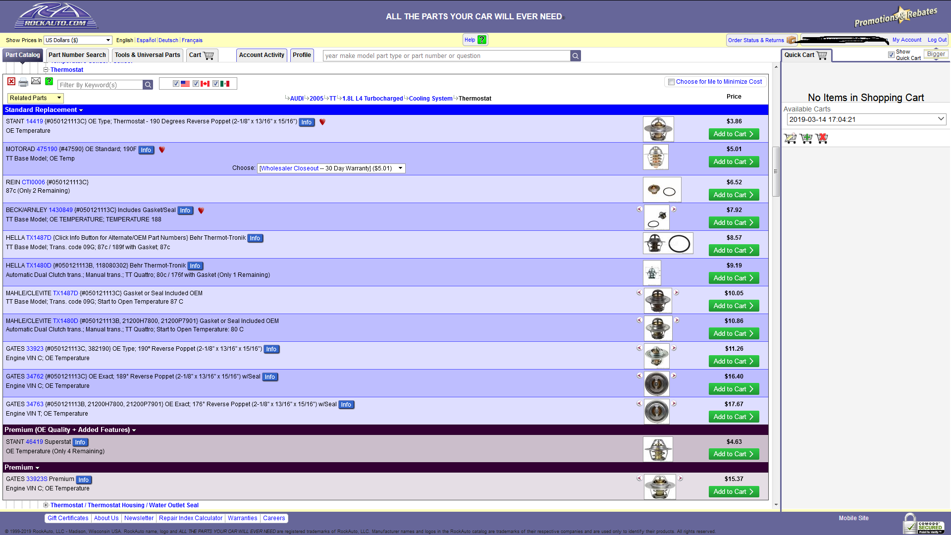

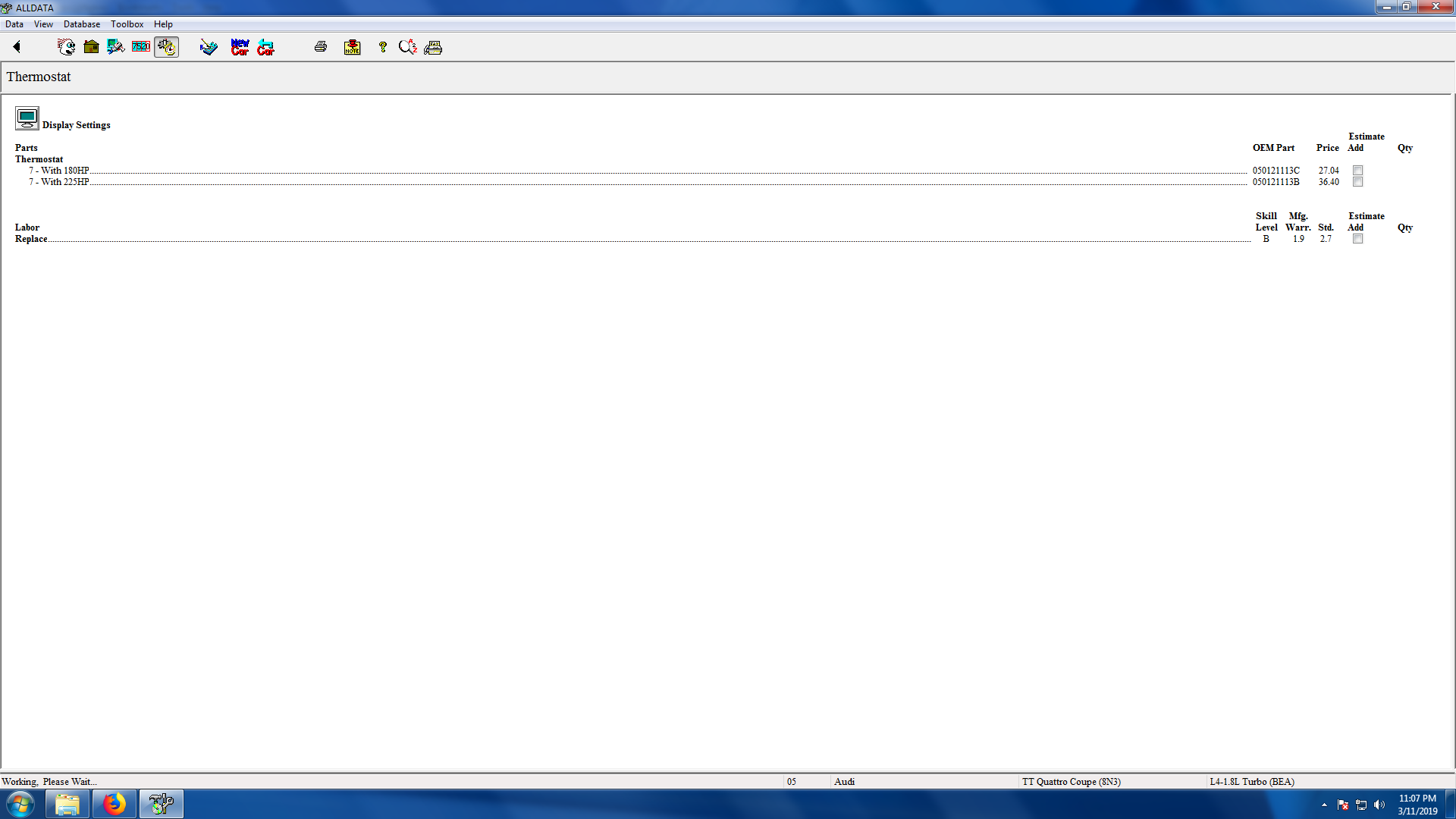

Also - no, the correct TT thermostat is an 87C version. 80 is far too cold for daily driving operation, even the racing thermostats for the car only go as low as 82C. If you put an 80C in the car it will not operate at the appropriate temperature.

I guess since your pump was fully in tact at 124k and since you put 40k on a "redesigned" pump it's proven? The fact alone that they redesigned it is a red flag and the fact that I have a service record that indicates at 71495 the engine was overheating and the water pump was the culprit is proof enough for me. Combine that with the stories i've read in my very limited research on timing belt services that state the pump was missing pieces or completely gone. I wouldn't run one if it was free.
I guess alldata is wrong and so is rockauto. No, i'd say they're correct.

I'm not going to argue with you about these things, but after six years of ownership and 70k total miles I have full confidence in my knowledge and the hours of research I've done on my car. The pumps were revised more than a decade ago, probably more like 15 years ago. We're not talking last year or five years ago, we're talking many years. Any cars that had a water pump failure received the new part and any that made it to the original timing belt interval received it by default.
On the thermostat - I'm disappointed that Alldata is incorrect in this case but I will save you the time for having to do the job twice and post this link: https://www.jimellisaudiparts.com/pr...50121113C.html
All versions of the TT use the same thermostat.

The thermostat that is in the car now is the correct part number and it was installed when they timing belt service was performed so that also proves that i'm right and you're wrong. The 80c is not operating it only specifies opening temp. I was waiting for you to read it, but once you know the truth there is nothing more to read I guess even if it's a few words. Alldata has surprised me many times over the years and they've always been right with oem part numbers IME, combine that with the fact rockauto is saying the same thing I guarantee they're right. I have no patience for people giving bad advice and stating it as fact when it comes to anything auto repair related. I'm not trying to argue I couldn't care less who you mislead, but it wont be me. Larger forums are filled with a **** ton of bad advice. Smaller forums with low production or low interest cars have been the best forums for raw knowledge i've ever experienced.
