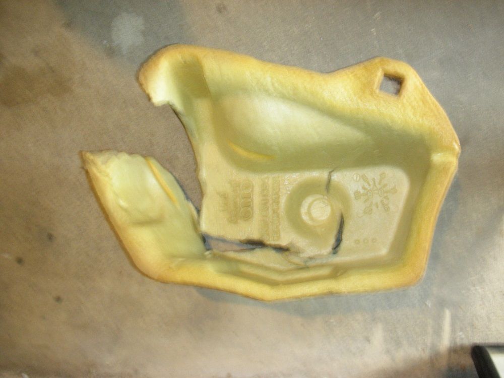

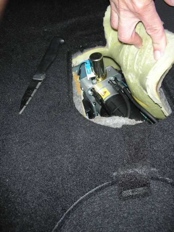

Pump with insulation uncovered under rear deck

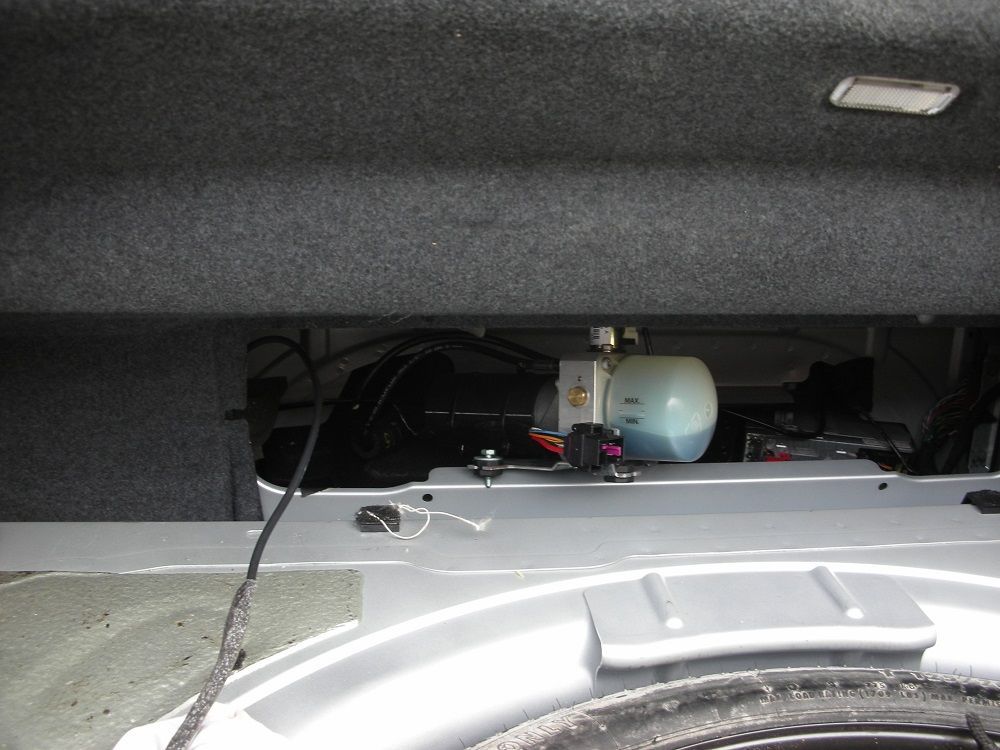

This is the trunk access to the pump.
Pump is swiveled around to get to the brass cover for filling.

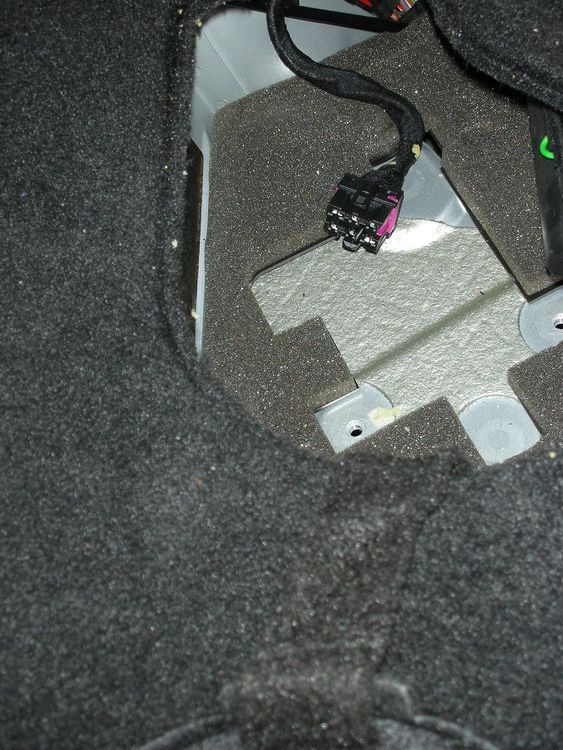

This is the space where the pump sits. You can see the bolts are above and below the motor. There's that darn connector, cussing helps!
Here is that cover, so much easier without that thing in the way!
