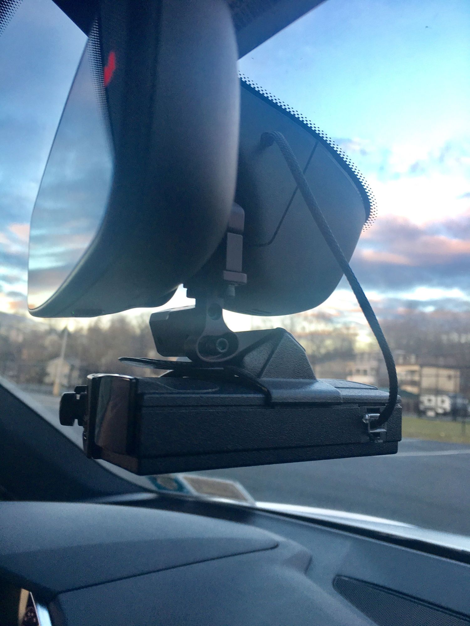

Yes I have used it on my MK3 with my Valintine one radar with blend mount and works great.
Could you please elaborate on how the wiretap was wired into your mirror?
The last one I had (for a 370Z) tapped into the back of the mirror. I see yours has a hole in the side of the mirror.
I'm picking my car up tomorrow, so I'm kind of flying blind on this.
Also, what Blendmount model did you order?
Thanks in advance!
Looks great, thanks for sharing. I too would love some more details, just picked up my TTS on Monday and know I'm going to need a solution really soon (almost done with break in).

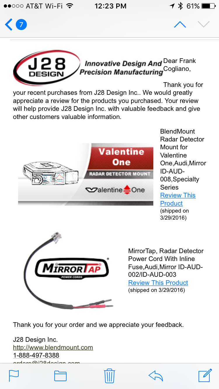

Below is a summary of the order for the blend mount and wire harness. The wires for the mirror is located in the housing that is attached to the windshield. It is easy to remove by pulling down at the top. I drilled a small hole and fed the wire thru and connected to the wire harness. It works great and looks built it.
Congrats on the new car. You will enjoy driving it everyday. Let me know if you have more questions.
