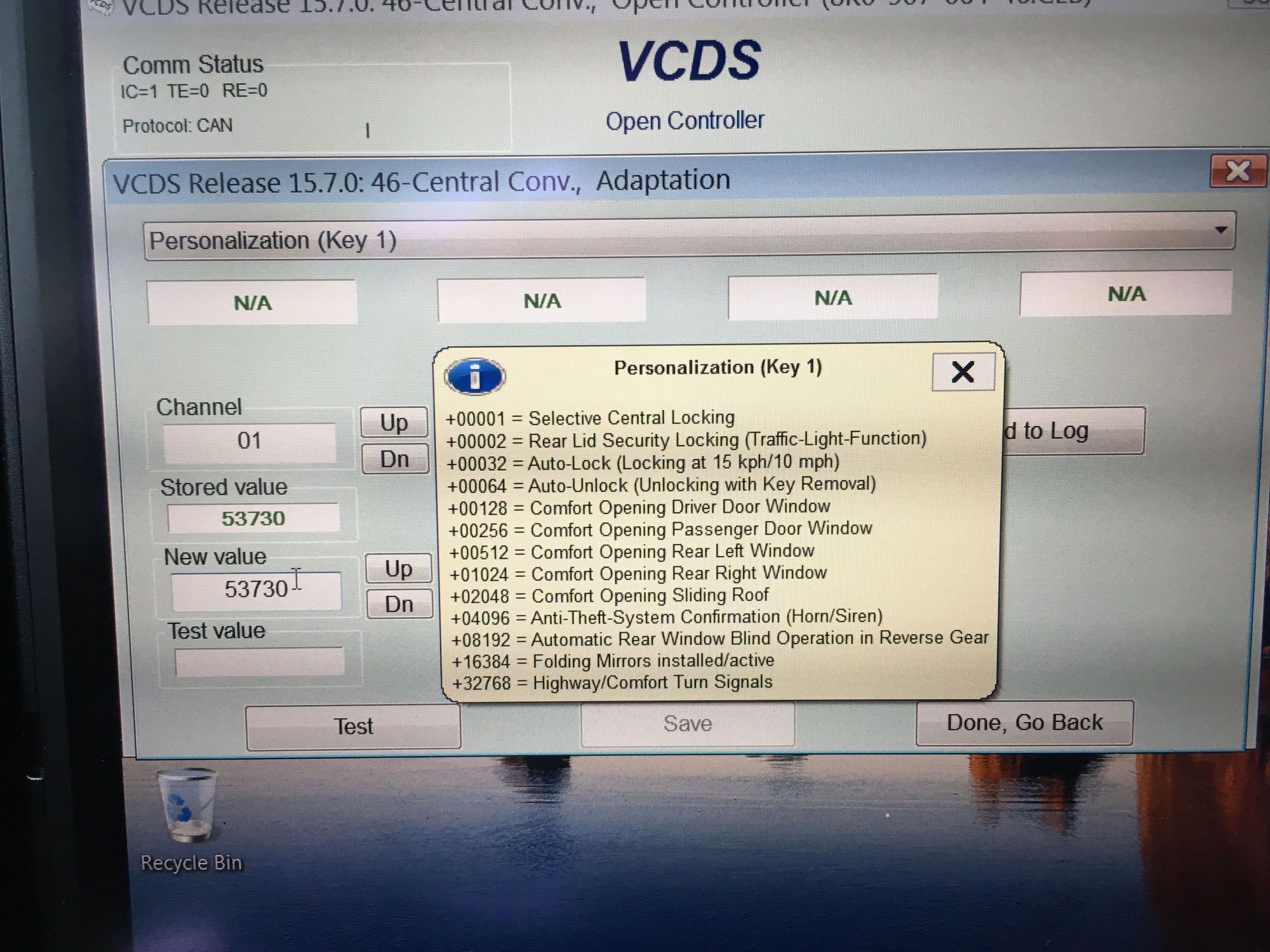

I have located:
+32768 = Highway/Comfort Turn signals
under module 46-Central Conv in a yellow pop up window with a number of other options starting at +00001 and doubling with each option until it reaches the last option of Highway/Comfort Signals
How do I change the value.

Thanks but my adaptation in 46 does not have the option.
I can see what I want to change in a yellow pop up window in Personalization key option but I don't know how to program the personalization key to identify the Highway Turn Signal option.

I'm trying to install Highway/Comfort Turn Signal. I am here but don't know the next steps. Please Help.

This field is called a bitmapped field. Basically, you have to add all the options you want and that gets you the value to set. So, right now, your value of 53730 means 2+32+64+128+256+4096+16384+32768. Normally these are used for yes/no fields, so I'm not sure how you'd set a counter for flashing here. This may just allow you to turn the function on/off.
