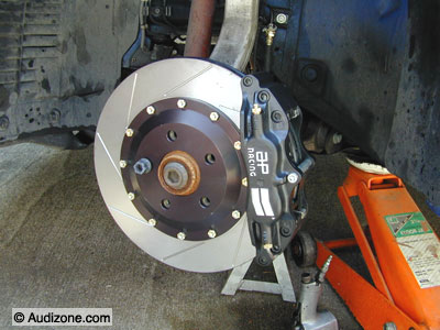

Stock vs. AP Racing
(ooooh, look how pretty)
click for full size images
Note: the upgraded rotor pictured is installed incorrectly. The rotor rotation is wrong
for proper cooling.
