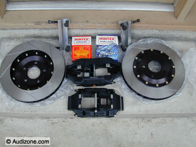

The Brake Kit
  • The brake kit (brake lines not shown)

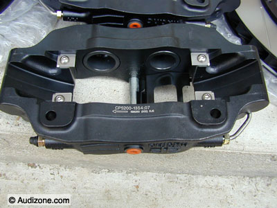

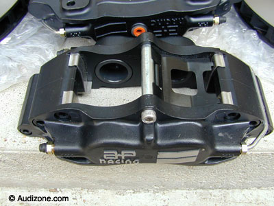

  • 4-piston brake caliper
  • Just another shot of the caliper

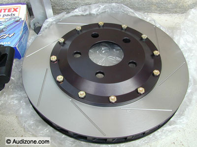

  • Coleman slotted rotors. The black center section is anodized aluminum vs. the stock rotors which are all cast iron.  This helps reduce the weight of the rotors by 8 lbs each.  Benefit: less rotational mass and unspring weight.
  • The new rotors are 330mm (13.0"). Stock rotors are 320mm (12.6").
