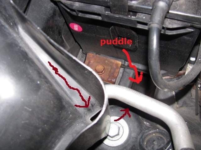

Is it supposed to drain water through the arrows?
<img src="http://cfile233.uf.daum.net/image/194C16514D6027D8340ADD">
I think my car seems to have some missing parts like a water deflector. Is the part I need to buy a rain channel (8D1 819 979 B), correct?

There is a gutter and no water onto the filter. Question was I see puddle (see picture) if it rains. In case of heavy rain, this puddle gets bigger. Is it normal? or is there any missing part?

Nothing missing, if I remember correctly there is a drain under the battery that may be blocked. Be sure you can reset your radio if you take the battery out.

There is a drain under the battery. If water is puddling then the drain is clogged. Remove battery and clean out the leaves and junk clogging it up.
