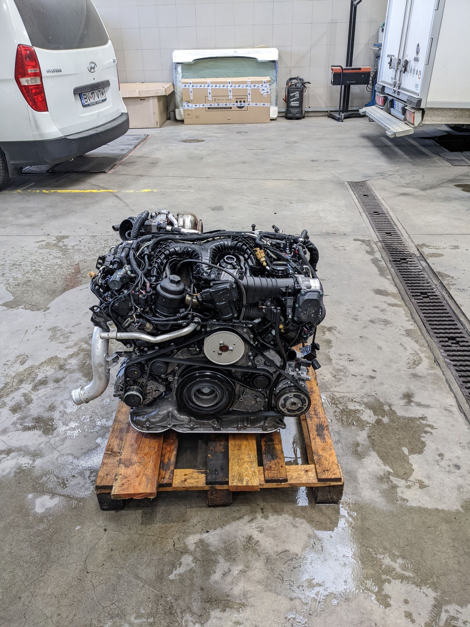

@142 guy unfortunately, i wasn't that lucky. My engine somehow blew a piston. Is all cracked, and the cylinder sleeve is also deeply scratched But...look at this baby I found one replacement engine with only 32k km. I can't wait to install it.

Engines don't really look like engines anymore. As far as I can tell, that thing could be the warp core from the starship Enterprise or a piece from the CERN Super Collider.
