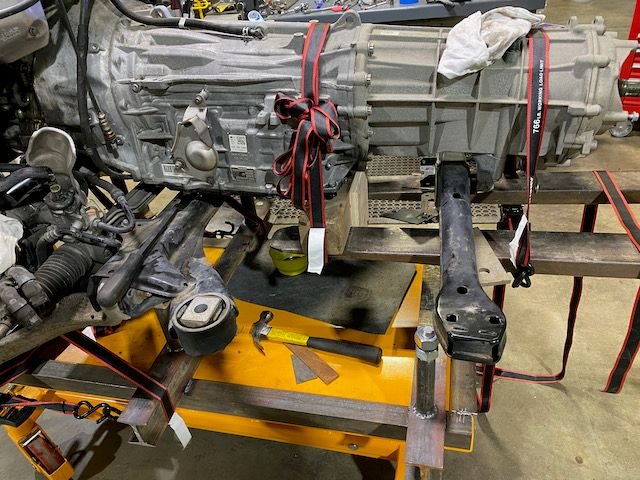

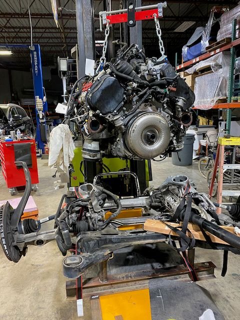

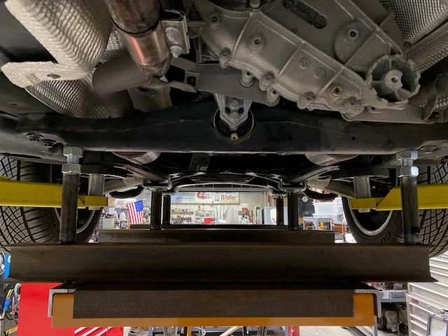

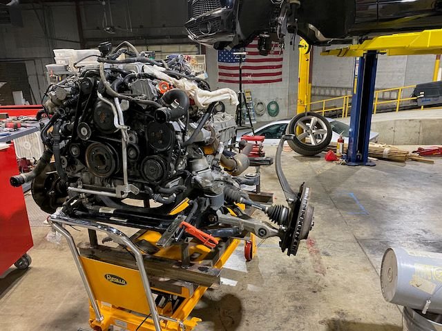

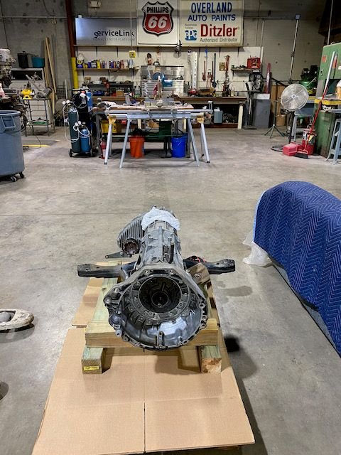

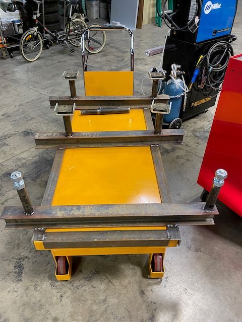

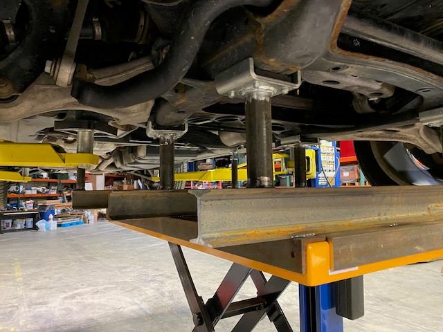

I've gone through the arduous task of removing the engine. I used a hydraulic table and welded up a jig to support the engine. (learned how to Tig weld and that was fun.) Dropped engine, removed trans with fork truck. Removed engine from sub frame.

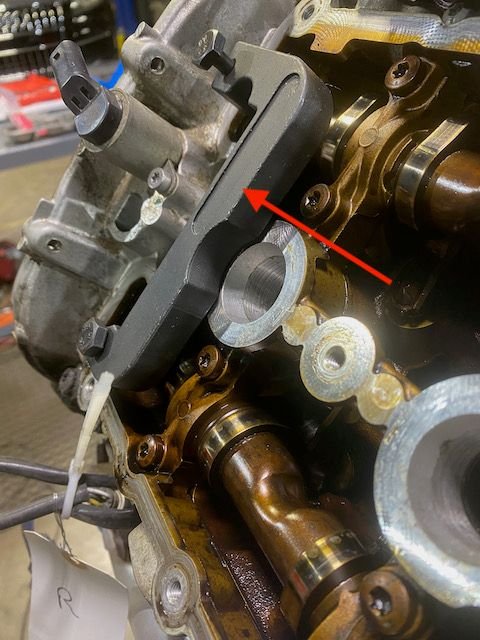

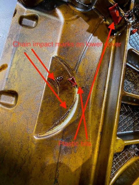

I'm into the engine now and found the tensioner failed on bank 2. (driver side). Have found bits of the plastic guides all over the timing chains. I think the bank 2 chain drive sprocket jumped a link or two because I cannot get both bank 1 & 2 to line up in TDC so I can attached the cam shaft holding brackets. There are marks on the lower timing chain cover at the chain drive sprocket that show the chain made contact with it. Please see attached pictures.

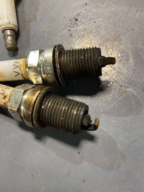

  • The spark plugs look pretty fouled, could this be because the ECU made adjustments to air/fuel mixture?

Jig to hold engine and sub frame
Failed tensioner and missing plastic guides
Locking bar on Bank 1 at TDC
Cams not in position on Bank 2 at TDC to install locking bar.

Impact marks of timing chain on lower timing chain cover.
Grungy spark plugs. All look the same.

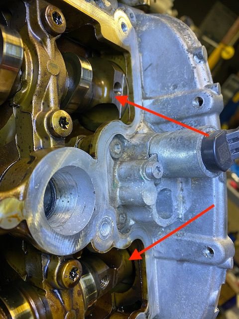

I have one more question. Does the intake camshaft adjuster fit into the three oil channels on the cam? Is it that the cutout on the adjuster fits into the center of the milled window on the head block?
