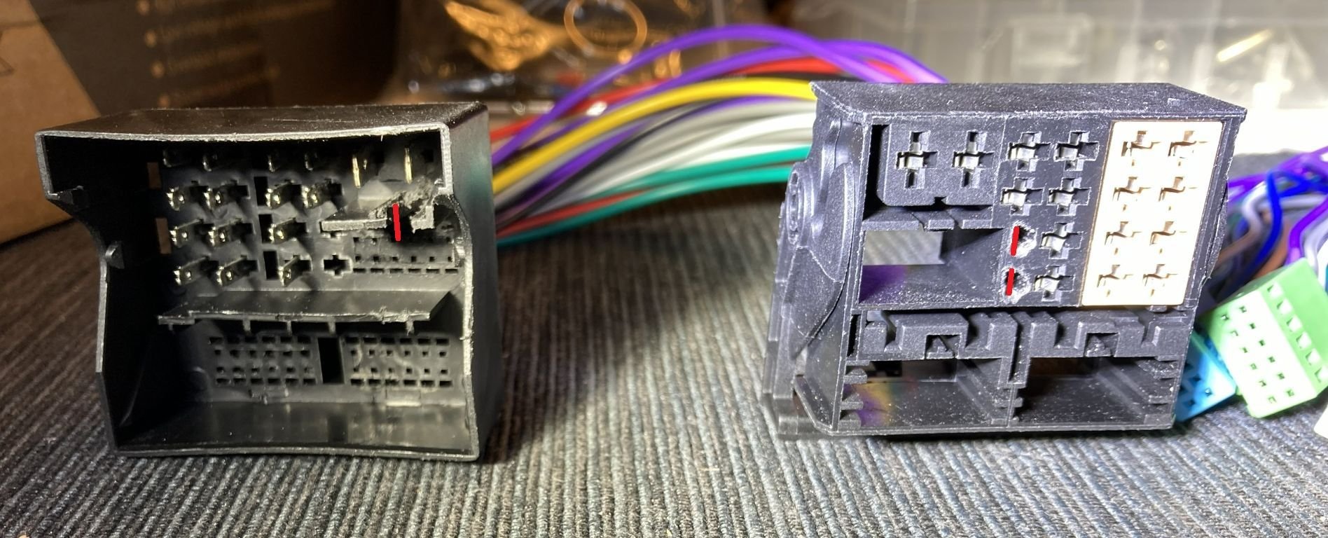

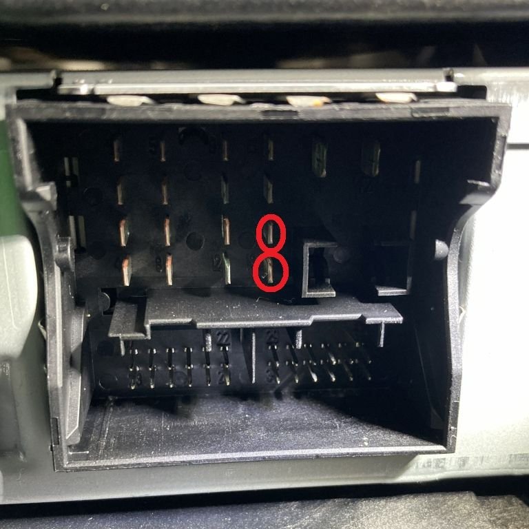

I'm just starting an audio upgrade project on my 2012 A6 standard 10 speaker system (non-Bose, non-B&O), and I didn't want to start a whole new thread because there's already a lot of great information here. I've found that the amp harness is very similar to the 52 pin Quadlock on the headunit with some modifications, so I got one from AliExpress for $10 so that I didn't have to cut up my original wires.
You can find the headunit pin out diagram here: https://pinoutguide.com/Car-Stereo-A...__pinout.shtml
Blocks B, C & D are not on the amp harness, so the relevant pins are:
A1 Loudspeaker (+), rear right, A5 Loudspeaker (–), rear right
A2 Loudspeaker (+), front right, A6 Loudspeaker (–), front right
A3 Loudspeaker (+), front left, A7 Loudspeaker (–), front left
A4 Loudspeaker (+), rear left, A8 Loudspeaker (–), rear left
A9 Subwoofer (+), A13 Subwoofer (-)
A10 Centre loudspeaker (+), A14 Centre loudspeaker (-)
I'm assuming A17 & A18 are the amp power wires but I didn't test them.

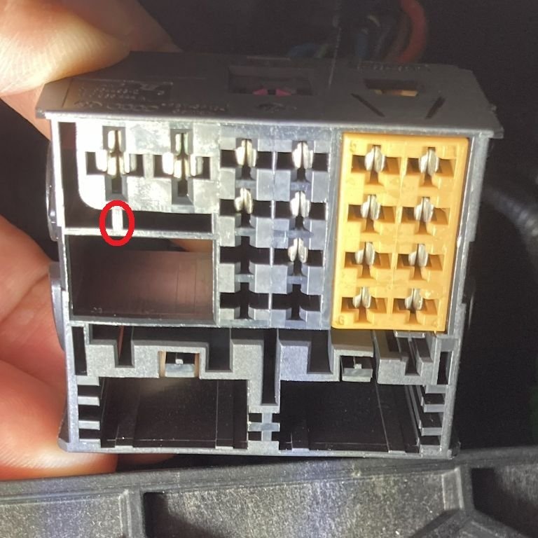

I have highlighted in red the parts you need to remove with a Dremel on the new Quadlock:
Original harness plug:
Socket on amp with 2 extra pins:
New 52 pin Quadlock harness with parts removed in red, as well as the 3 unnecessary blocks B, C & D removed and de-pinned:

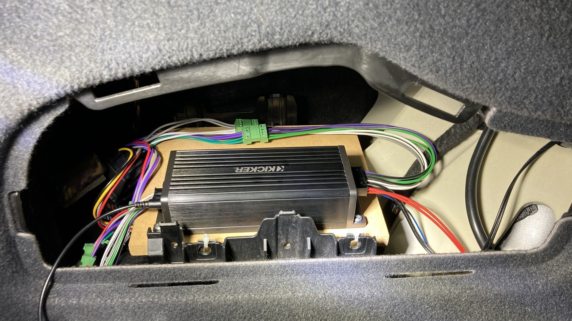

Stage 1: Kicker KEY 200.4 amp with Auto EQ
Total cost: ~$300
This is a great first stage upgrade even if you want to stay on the stock speakers. The amp comes with a microphone to do Auto EQ and time alignment. It does a great job to bring the soundstage to the front and center, and the sound is clear with good bass even though I unplugged the center speaker and sub (you have to unplug them when running the Auto EQ setup).
Installation time should be 1-2 hours and is completely reversible to stock.

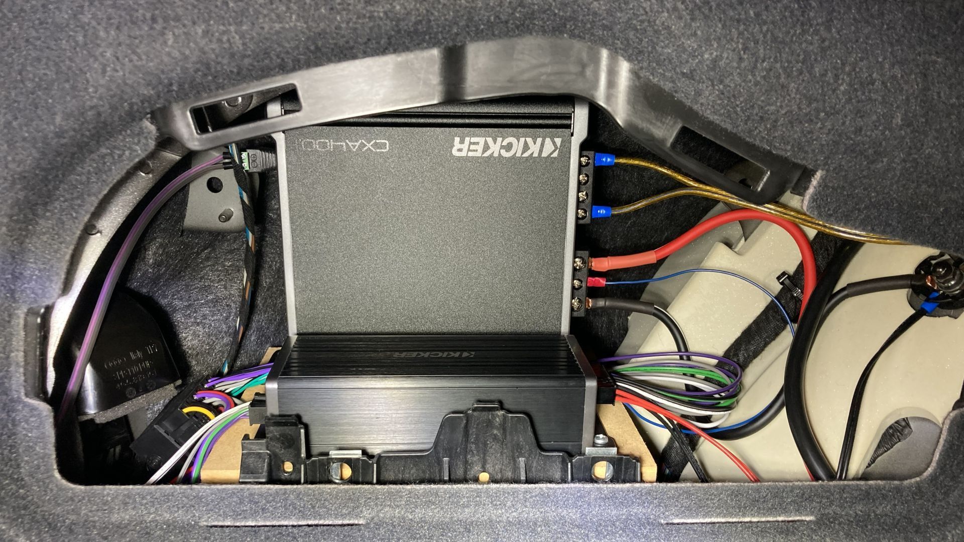

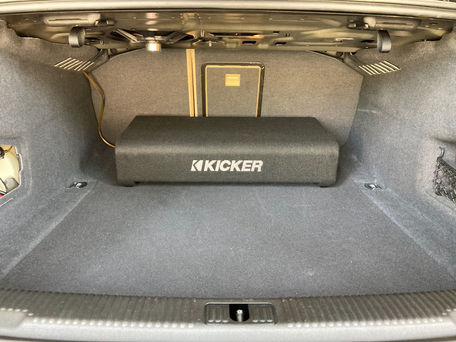

Installed a Kicker TRTP122 12" CompRT sub with passive radiator, and a CXA 400.1 300W into 2 Ohm mono amp.
I'm still running the stock speakers which are actually 8" in the front doors so they already put out some bass after the Kicker KEY amp did its Auto EQ, but I think the sub will still help on the highway where road noise drowns out the bass.
The A6 trunk is quite long and you can put things on top of this sub so you don't really have to worry about losing trunk space.

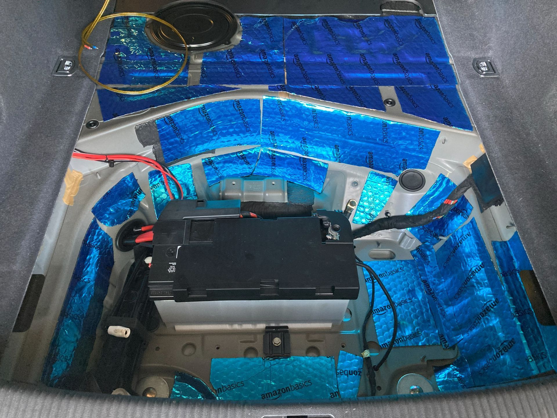

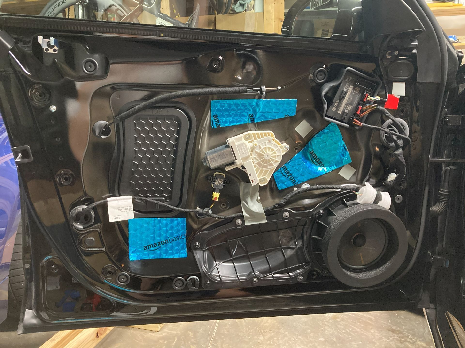

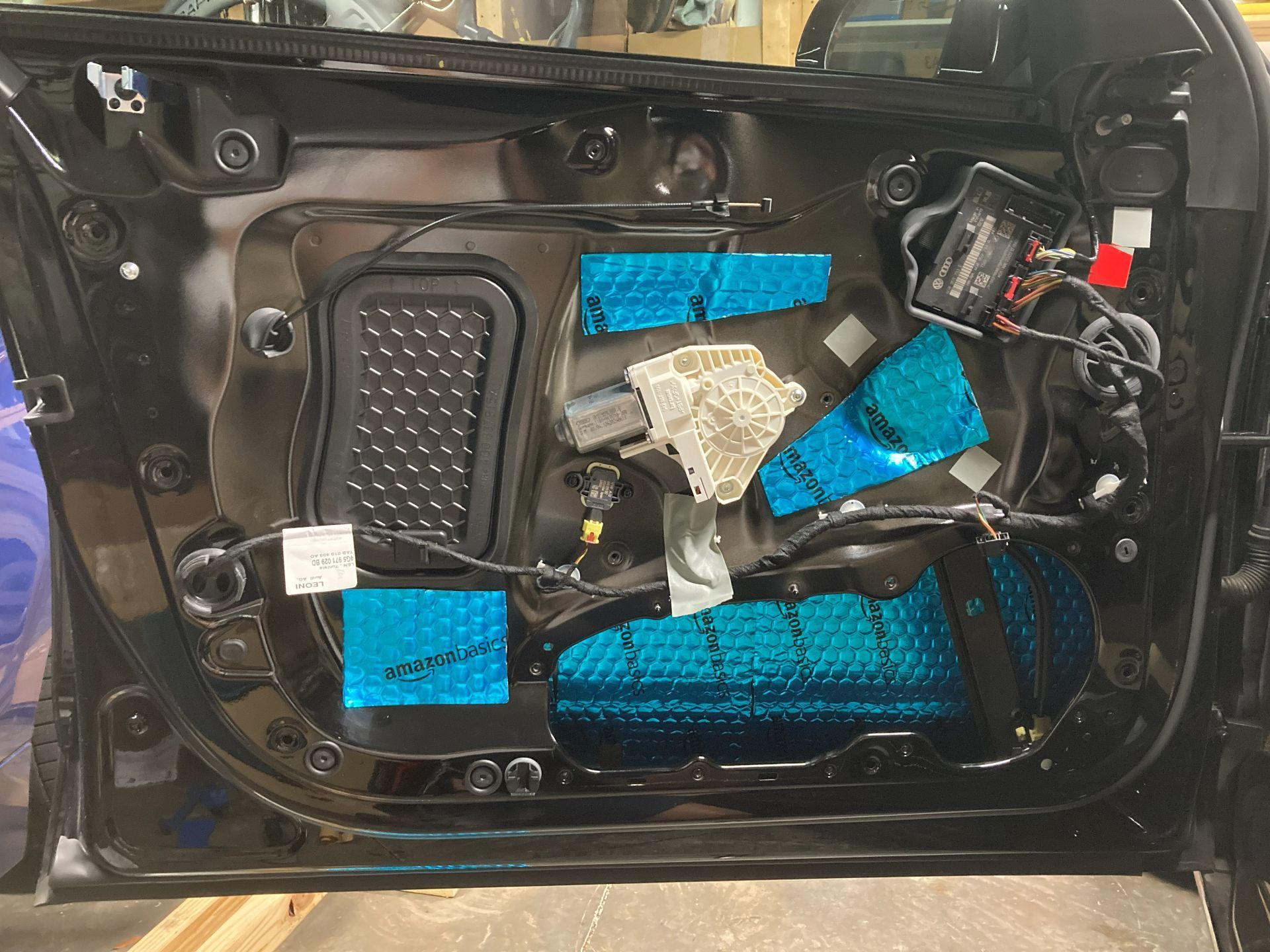

Kicker KSS 6.5" speakers installed in the front doors, and sound deadening applied to the back side of the outer door skins. These actually have less bass than the original 8" speakers so it's a good thing I put in a sub.

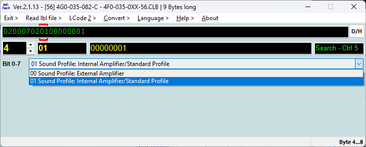

I saw on the internet that some people were saying you could recode the radio/amp to output more bass. In VCDS the setting for my 2012 A6 base stereo is in the [56] Radio module, byte 4, change it to 00 Sound Profile: External Amplifier.
Yes, there was more bass, but actually way too much bass. I checked the Front Right signal coming out of the factory amp with an RTA and got the image below. The bass actually rolls up below 500 Hz up to 30 dB. Something was obviously not right here so I put the coding back to Internal Amp.
