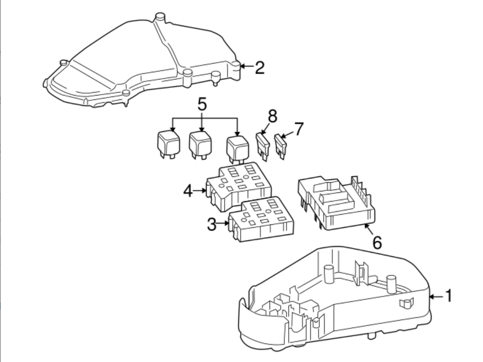

I've now managed to locate the Glow Plug Control Module / Relay. I found there was very little information out there on this so have included some images and tips which may help others experiencing similar issues.
On my vehicle the relay panel was located in the bulkhead area on the drivers side (Right Hand Drive). To get to it you'll need to remove the black trim that covers the bulkhead. This can be removed very easily by removing the rubber seal then gently wiggling the plastic trim out.
Once removed you'll see the ECU unit is covering the relay panel. This can be removed and gently placed to one side by pulling the plastic clip which holds it in place.
Once the ECU is out of the way you'll have access to the relay panel, it's a sealed unit and you'll need to remove the 5 torx screws. Once the lids off you'll be looking for the relay numbered 651.
Glow plug control module (651)
The part number is: 4L0 907 282 A I looked around and it seems this part is not readily avaliable, so I called Bosch who advised me that they hold the patent on this part and only supply it to Audi, so you'll need to order it through your local main dealership. Im in the UK and was quoted £97.43 for a replacement.
Here's a view of the pins, you can see the glow plug circuits labelled #G1 - #G6
Glow plug module
