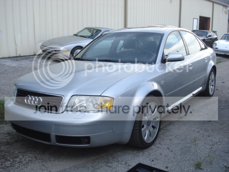

Been in the VW scene for a while (over on the 'tex) and I finally picked up my first Audi today!
2001 A6 4.2 V8 105k miles
Almost every option, including Nav, Sport Package, and Premium Package.
Lovin' it so far. Tomorrow she goes to make sure the compression is good and see about a slight noise in the front right, which gets louder as I go faster (sounds like a wheel bearing).
Other little fixes I'll be looking into are: The info screen in the gauge cluster has some display lines burnt out (Can the whole cluster just be replaced and the mileage adjusted?); Driver's seat lumbar not working (Replace just bladder??); Homelink not working (Maybe wiring or internal battery??); Rear Parking sensors not working (Not sure); Nav DVD's missing (Can these be copied from another car??)
Also, the car was prewired for the built-in phone, can anything else be used in there, like some kind of bluetooth integration??
Cosmetically, the headlights are somewhat hazy, has anyone used the LED DRL style ones like they sell over at TMTuning.com??
One of the tail-lights has a slight crack, so I'd also like to get the LED versions, which I think look more up to date...
Finally, the front bumper has quite a few rock chips, so I'd eventually like to get the RS6-style version... Any other thoughts??
