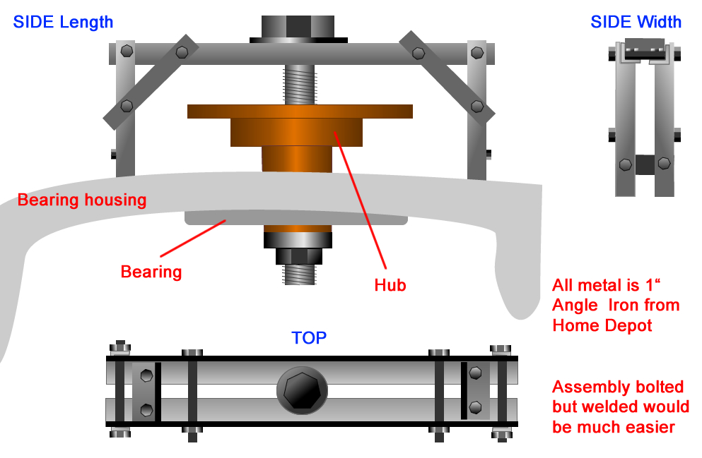

I bought this tool today and preparing to do this work. But how did you get the hub and the bearings separated with this tool? I imagine you used a two arm puller as well?

There is one piece missing, that I totally forgot about. I fabbed up a Hub puller from some 1" angle iron I had laying around. Hope this pic makes sense, I welded mine together, but I figured not everyone has a welder so I drew it up using bolts. http://www.vaglinks.com/Pics/WheelBe...Hub_Puller.jpg
You will need to do this first (pull the hub out of the bearing) so the bearing can come out the back of the housing (control arm). I "overdid" mine and made it extremely solid, but it really does not need to be, just as an FYI. I used the bolt and one of the "plates" from the set you got to do the pulling.
