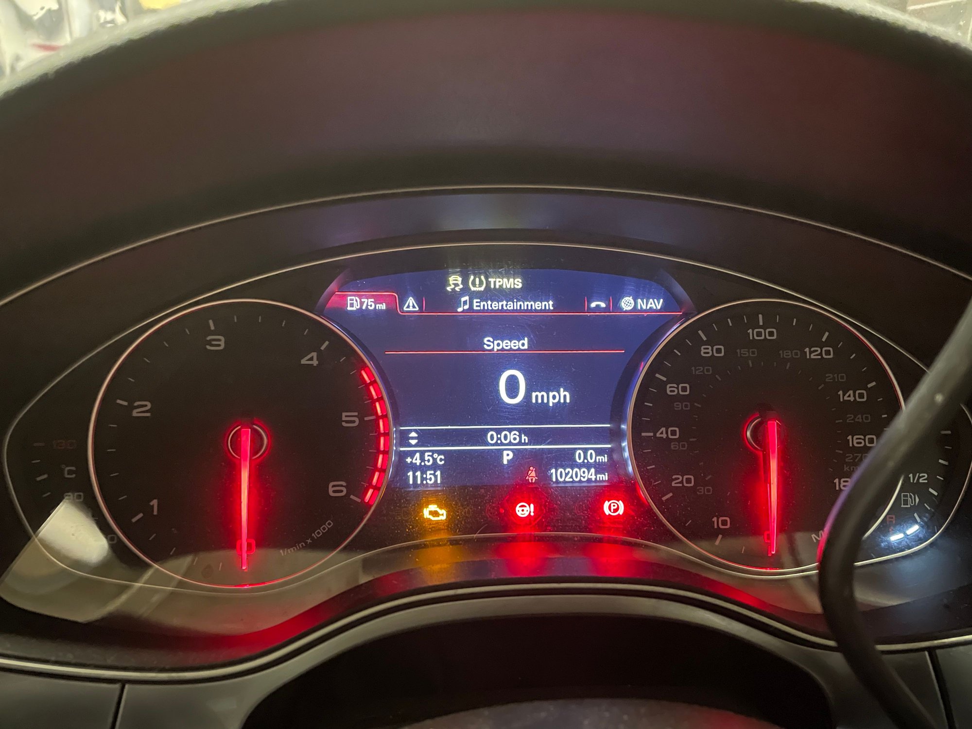

Hi there can anyone help me here got an Audi A7 4 months ago power streering went so solved it with a second hand on reprogrammed it worked fine until last week when red light don’t not drive came on with Tpms light , anti skid , stop/start, malfunction, don’t know what to do nxt I’ve got it plugged in and these are the pic any help would be great .

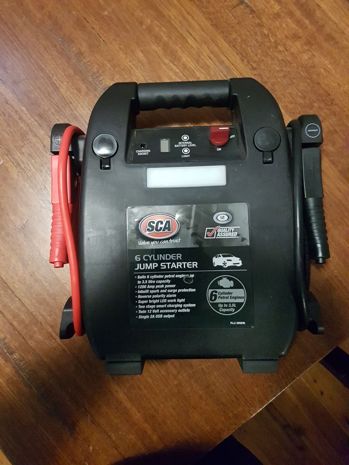

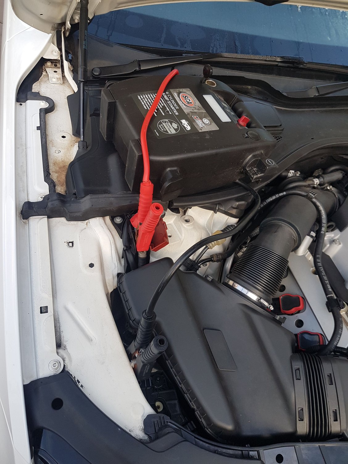

I had a similar issue and it was a bad battery. I was able to test by connecting a battery jumper back ( to make sure battery charge was adequate ) then turn car on.... faults didn't come on... disconnected jumper start kit, turned car off... turned on again and fault returned .
Might be a long shot, but mine I put in a new battery had them recode it and the car has been fine ever since.

Default this is what I did to test
Hope it works out...
