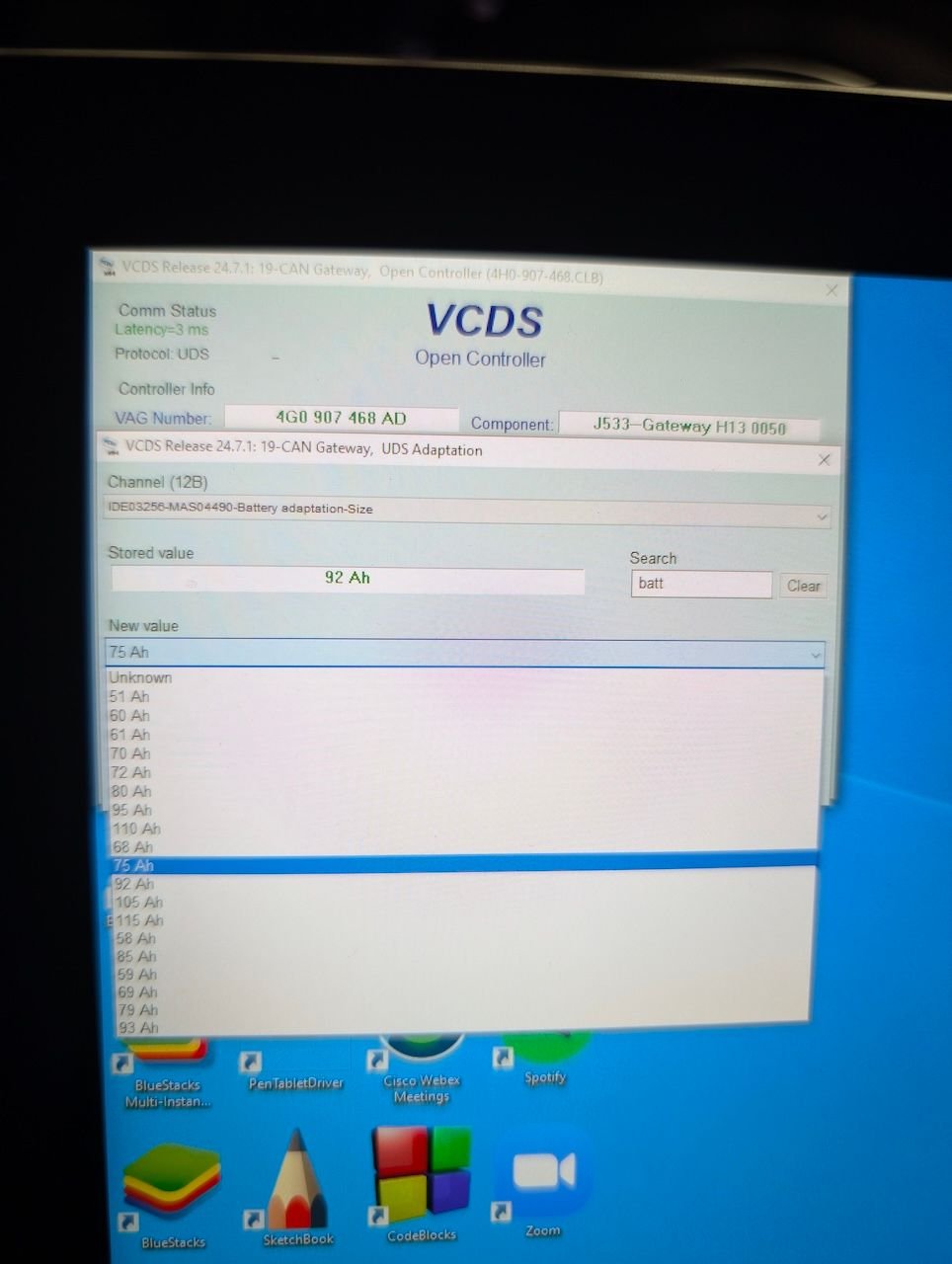

Based on almost all the threads I have gone through, the recommendation is to just increment on the of the digits in the serial# and that is all that is required. But the current serial number coded is reported by VCDS as a text string. No numbers at all. What is a good solution in this case?
Can I choose the manufacturer as Unknown(it is actually HAN as per the new battery serial) and use the serial number from the newly purchased battery instead?
Should I also change size to 95 Ah from the current value of 92 Ah?
Existing serial# reported by VCDS
Battery manufacturer dropdown. Current battery is a Varta.
Battery size dropdown. Currently 92 Ah.
Old battery numbers.

When I changed the battery in my old A7 I did not re-code the battery and saw no ill effects from it.
As I understand, changing the serial number somehow makes the car know that the battery has changed and the charging system will adjust as if its a new battery. Smart charging system?
How long did you use the battery after replacing? Did it last the typical 7+ years?
Old Dec 12, 2024 | 09:46 AM
Valpo A7's Avatar
Joined: Dec 2018
Posts: 783
Likes: 134
Original battery made it 8 years. Replacement battery who knows. I replaced the original battery Dec 2020 and traded the car Dec 2023.
