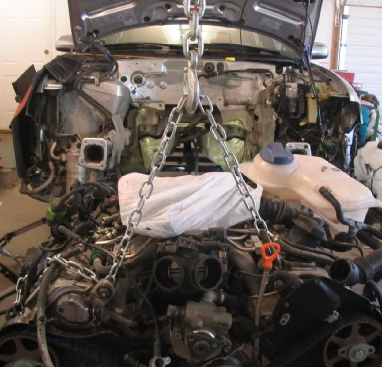

I know it’s not what you want to hear but I 100% agree move the power train to the good chassis.
Just curious what is preventing you from moving the power train? One example @Bigvaglover pulled his V8 drivetrain and rebuilt half the engine in his outdoor parking lot using a harbour freight hydraulic lift table and jack stands.
I’m spoiled with a scissor lift and engine hoist
