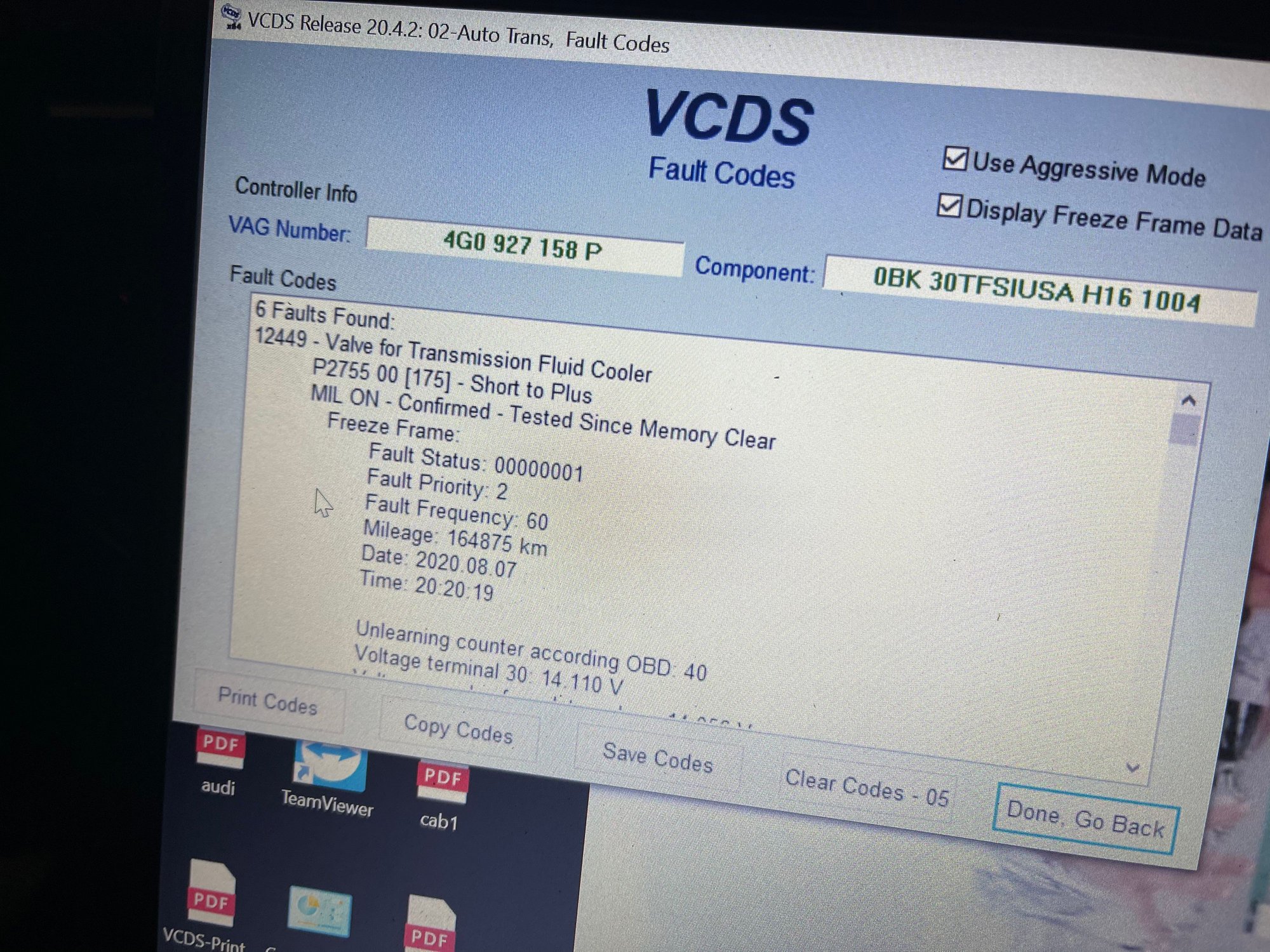

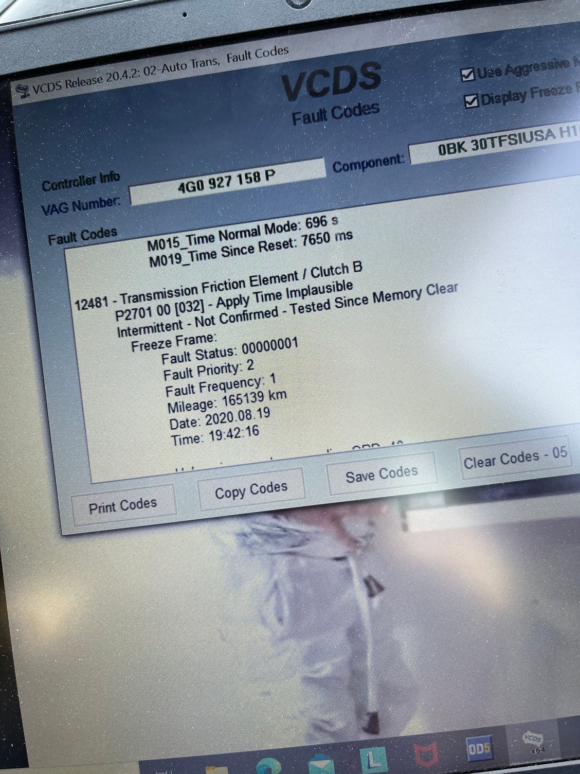

I recently got an A7 2012 - Prestige package with an 8 Speed automatic gearbox. But i’ve been facing some issues with it. There have been some codes which kinda come and go and when the codes are present the car drives extremely weird or does not moves at all. If i shut off the car and start it again it drives fine and all gear shift fine.
I did change the selenoid underneath the car but that didn’t change anything. Nor did the connector had any water damage atleast from the looks of it. But the previous guy had taped the wire to it so and had grounded it to a bolt by cutting one of the wires maybe so i assume he already tried his luck then sold it off.
The workshop the car is at currently suggests we should change the clutches and i should order a rebuild kit online. Does anyone has any information about this issue?. I have attached the codes. P2755 is the code which usually comes first and stays for longer and does not reset when i try to through VCDS rest goes for a while comes back after sometime.

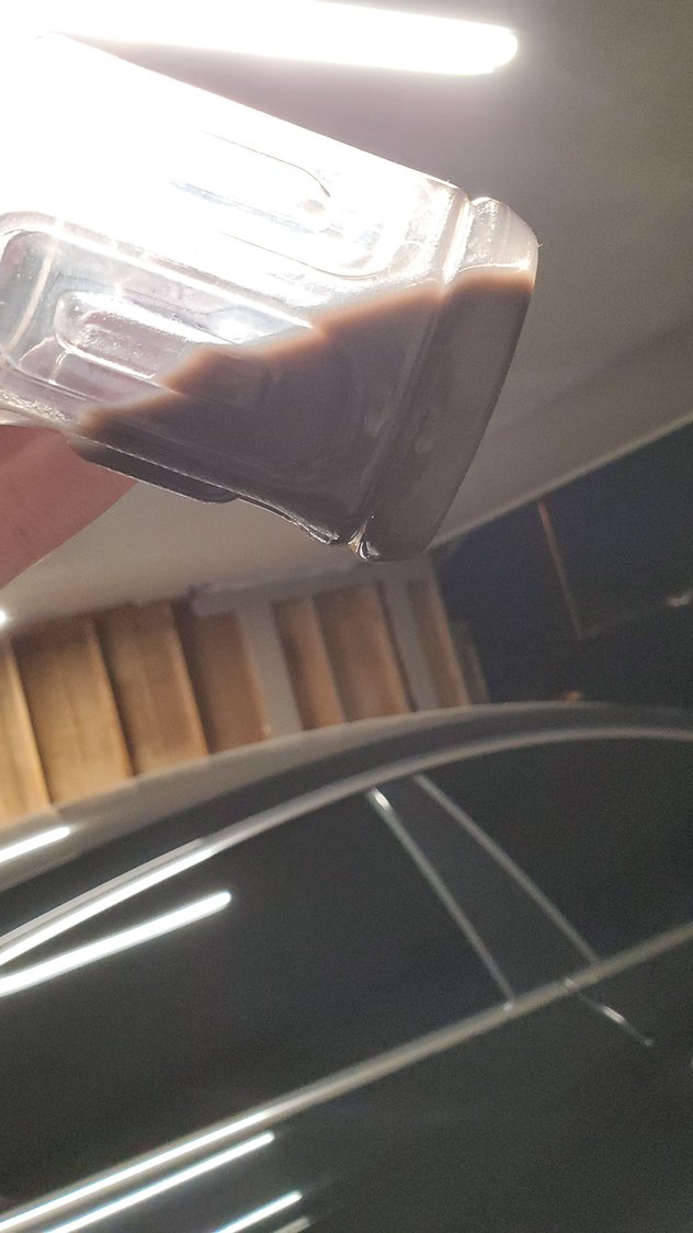

Sorry for the late response also sorry in advance for the long explanation.
As of right now I ordered the valve body, I'm trying to avoid going for removal of the transmission as I know it will be very expensive(but know it will probably have to happen). What's confusing is the codes I'm getting are (P2701 Transmission Friction Element B Apply Time Range/Performance), (P0730 Incorrect Gear Ratio) and the final one being (P0337 Crankshaft Position Sensor A Circuit Low Input) but the sensor is good and the voltages are correct. Also the engine idles and revs fine(but is in limp mode). So to me that means that something is wrong with the tcm not doing its job. Maybe its sending bad data causing these codes, Especially how it's shifts up for no reason when put into drive and let your foot off the brake.
At the same time, based off common symptoms of P2701 dirty fluid causing damage, and let me tell you, this stuff is not see through and is very brown and what possibly seems like a water layer floating at the top, I'm not sure though, (I'll post a picuture of it) I'm not sure what to think.

This is what it looks like... extremely dirty, definitely was not maintained correctly.

Valve body rarely gets bad and you can easily open it order the correct gasket for it clean it all up and put it back together.
Your best bet would’ve been mechatronic instead of a valve body. Also most of the times what i’ve seen is that the codes in the transmission don’t really reflect what’s actually wrong & in most cases it’s either the clutches or the mechatronic whenever you get such codes.
Also your oil looks bad. By any chance have you noticed if your oil cooler for the trans has not leaked?
