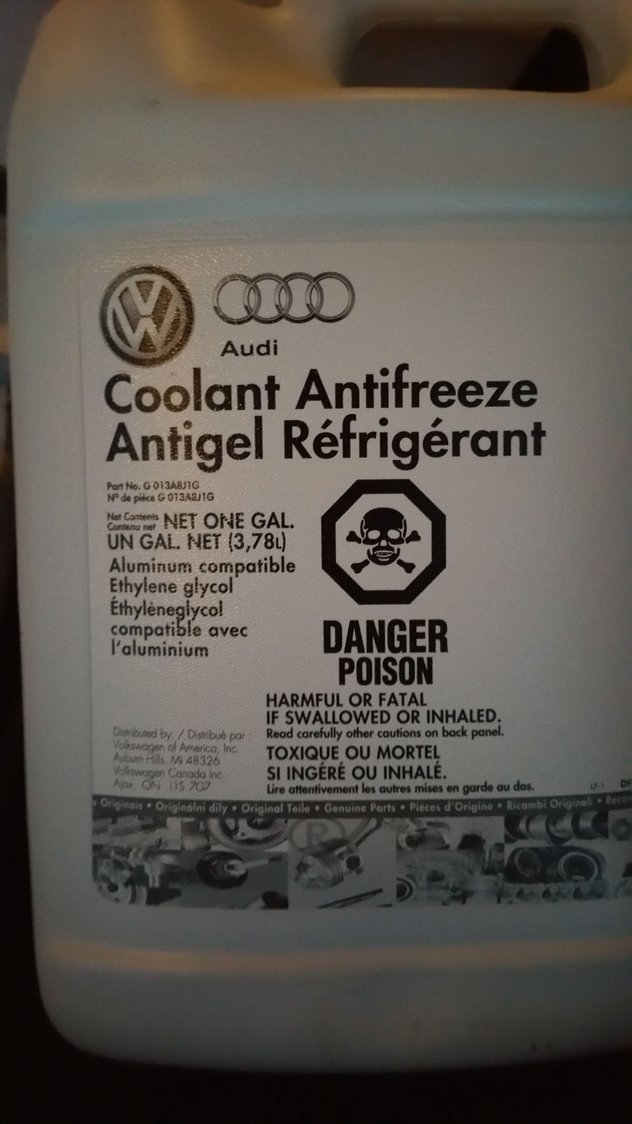

Is this the right coolant for my 08 A8L 4.2L
I picked it up from a VW dealership near my house.

Default Yes, that is current formulation G13.
As an 2008 it was probably shipped with G12++, which you can't get any more from Audi/VW. Still available in Pentosin brand. Audi dealer stuff like you got is often as cheap or cheaper now than G12++.
G12++ and G13 can be mixed, and the only apparent difference is more glycerin in G13. Has to do with them wanting to claim a carbon reduction, not a formulation quality related one as best I can tell.

Default Great...
Thank you. I've been searching for a clear cut answer.

Default FWIW attached is 2008 A8/S8 fluid capacity (& type) chart
from some years back. Cross out G12++ and write in G13 in this case.
