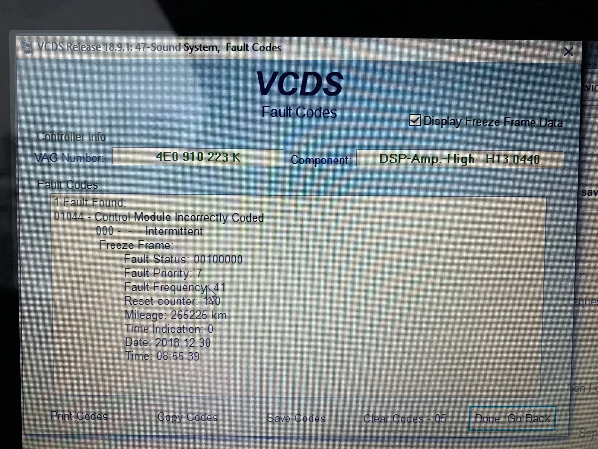

So I’ve been having problems with this fault

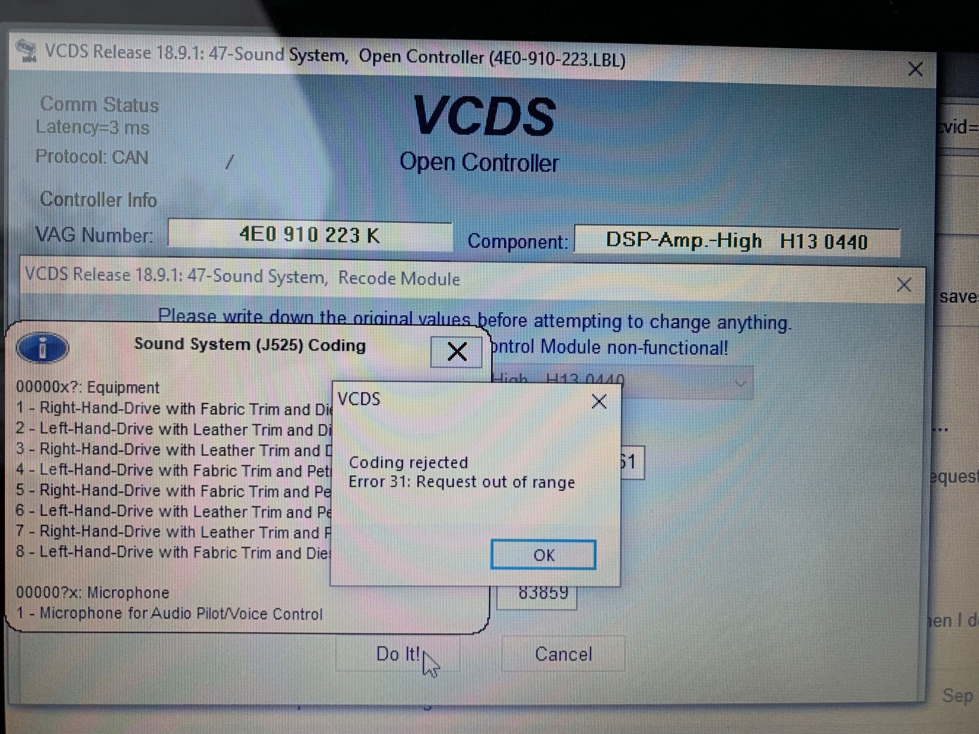

So i take take a look at it and it’s roght, the 1 and 6 are backwards
So i retype it the way it should be and then this happens
Any idea what the problem could be?

You're reading it backwards, I think. The question mark is the value being referenced, not the x.

any other ideas what that fault could be?

What are the values you are getting? I don't see them in the photo.
Oh, the initial fault. Yes, probably in the green screen, there is a list of installed equipment there and if you have something installed that isn't checked, it throws that error.

Ok, I see the other photos now. Not sure about the initial fault, but Jack is right about the error you are getting. You have the numbers backwards. the ? is the spot you are looking at.
