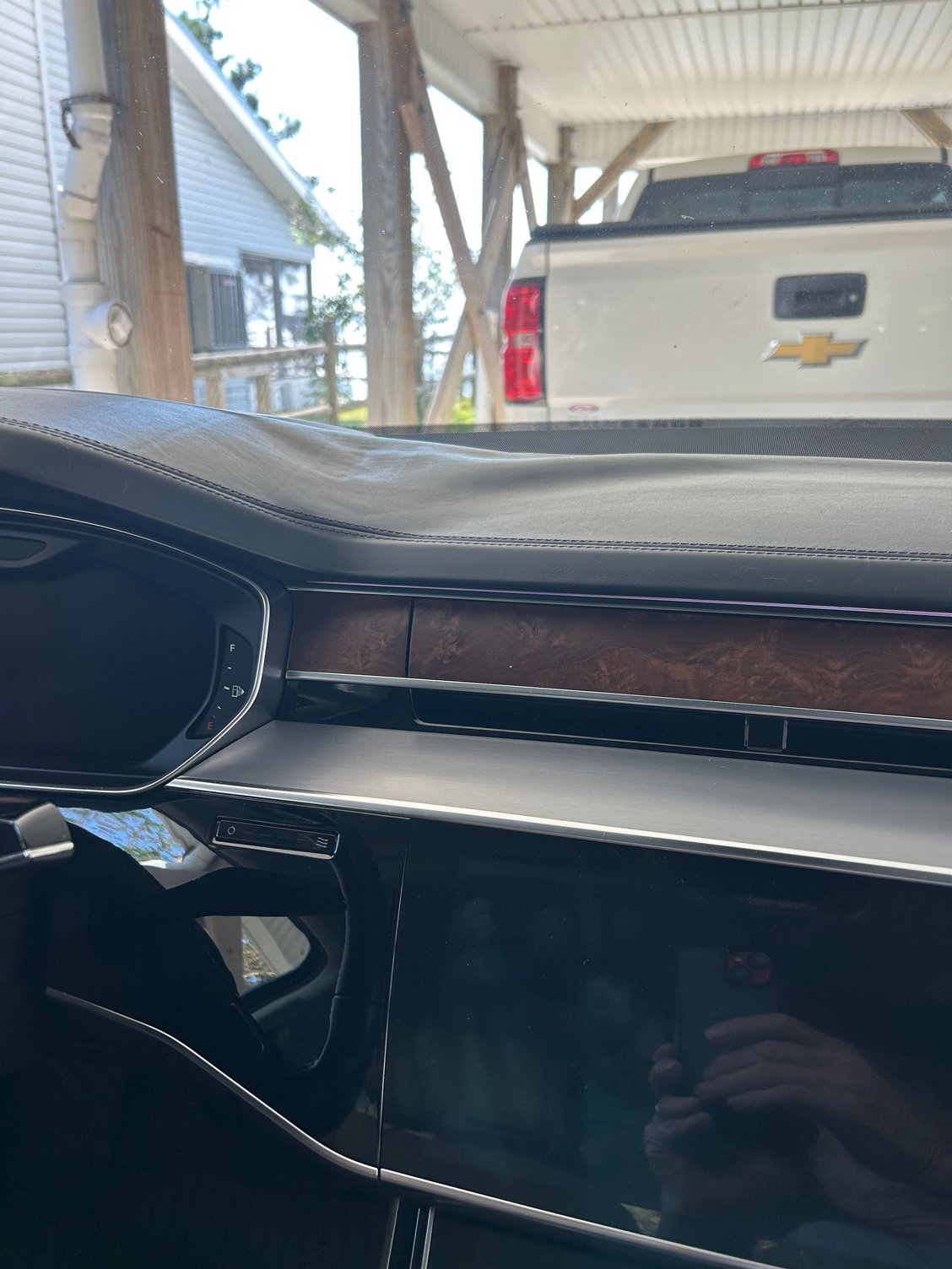

Has anyone had this problem? I purchased a new to me 19 A8 in Jan this year. About 2 months ago it started to loosen in the middle of the dash. I asked the dealer and he stated that this would be approximately $6000. To replace. Any information would be greatly appreciated. I love the car, but not 6000 worth.

Can you post a photo of this? Just curious to see what's the extent of it.

It’s not terrible by any means, but for this much for an automobile, it shouldn’t be doing this.

Thanks for the pics. No, that's not good. Hopefully a pro auto upholsterer can resolve it. Instrument panel removal is probably a PITA, but likely required. It would be a shame (and ridiculously costly) to have to replace with a whole new leather top. I wonder if some external event beyond "normal" wear did that.
Good luck with it, and please let us know what the result was if you proceed on getting this fixed.

This is a common Audi problem. The R8 dash does the same thing and there's a TSB on it.

It's due to poorly performing adhesives. Limiting sun exposure should help but I think over time it's still going to happen. I always tint my front windshield which should also help.
