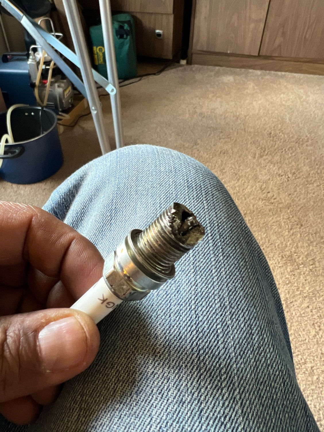

Old Apr 22, 2022 | 05:03 PM
blackspace's Avatar
Joined: Nov 2010
Posts: 15
From: detroit
Default Well I guess this answers my Question lol
I guess safe to say damaged position ???

Borescope it and see what's up inside. For it to smash the plug though? Even broken chain won't do that. The piston shouldn't be able to physically reach the plug, no?
