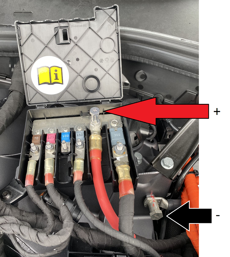

I reckon it is the 12V battery, if you have a trickle charger, you can try the charge the 12V battery (switch of the car before you do it).

You don't have to dig deep to connect to the battery itself. There are dedicated "remote" terminals for that under the hood on the passenger side, connected directly to the battery with thick cables. Just keep in mind that these are not fused, so avoid any short (which you also would need to avoid when connecting to the battery itself).
perfect
