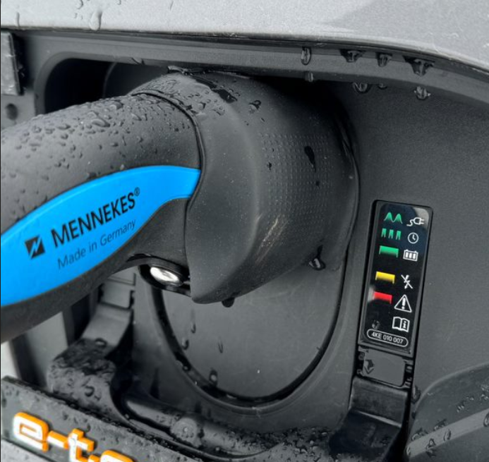

This is the culprit - this button and the mechanism behind it is not in any way waterproof, nor does it drain, so when water gets in and freezes, the button, which has lots of travel, does not move enough to click actuator somewhere in there because there's a bunch of ice behind it, meaning the connector is locked into the car.
I know it's a slightly niche issue but has anyone solved this design fault? I'm amazed it was never dealt with by Audi across the revisions. I'm not going the dealer route again - their solution to this issue on my 2022 was "leave it in the warm dealership for a couple of days" so the ice melts - not practical if you need to, I dunno, drive your car anytime in winter. I'm considering finding an appropriately-sized black rubber band and slipping it around the button, assuming the water gets in from the front.

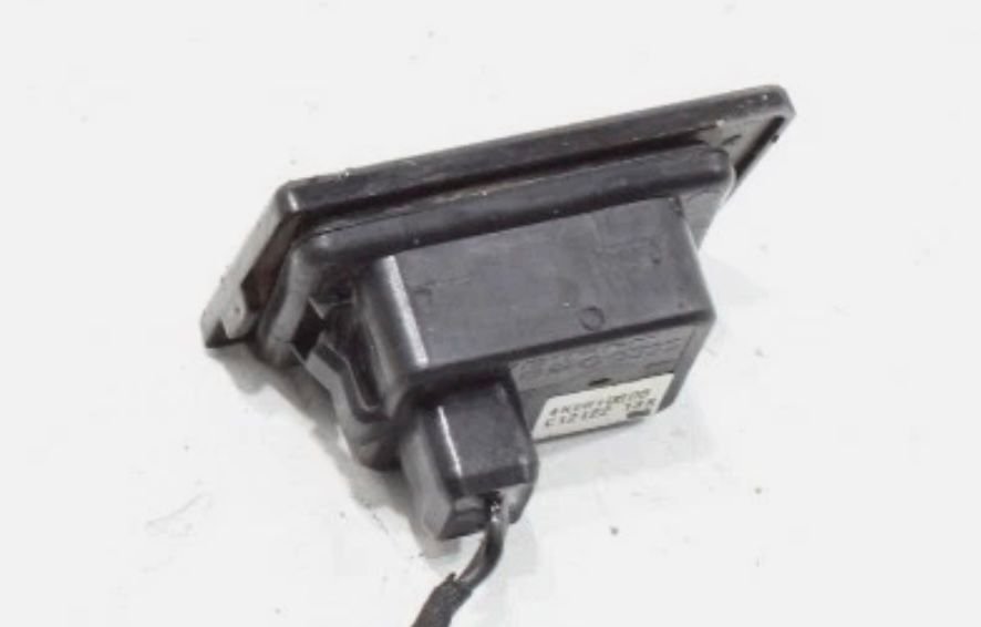

Managed to find a (potato quality) picture of the back of the button. My bet is water gets in one or more parts of this thing. There is some kind of rubber gasket - seems the most likely culprit seeing as the "click" goes AWOL when it ices up, so I don't think it's an electrical issue. So strange they put rubber there but didn't make it actually sealed?
