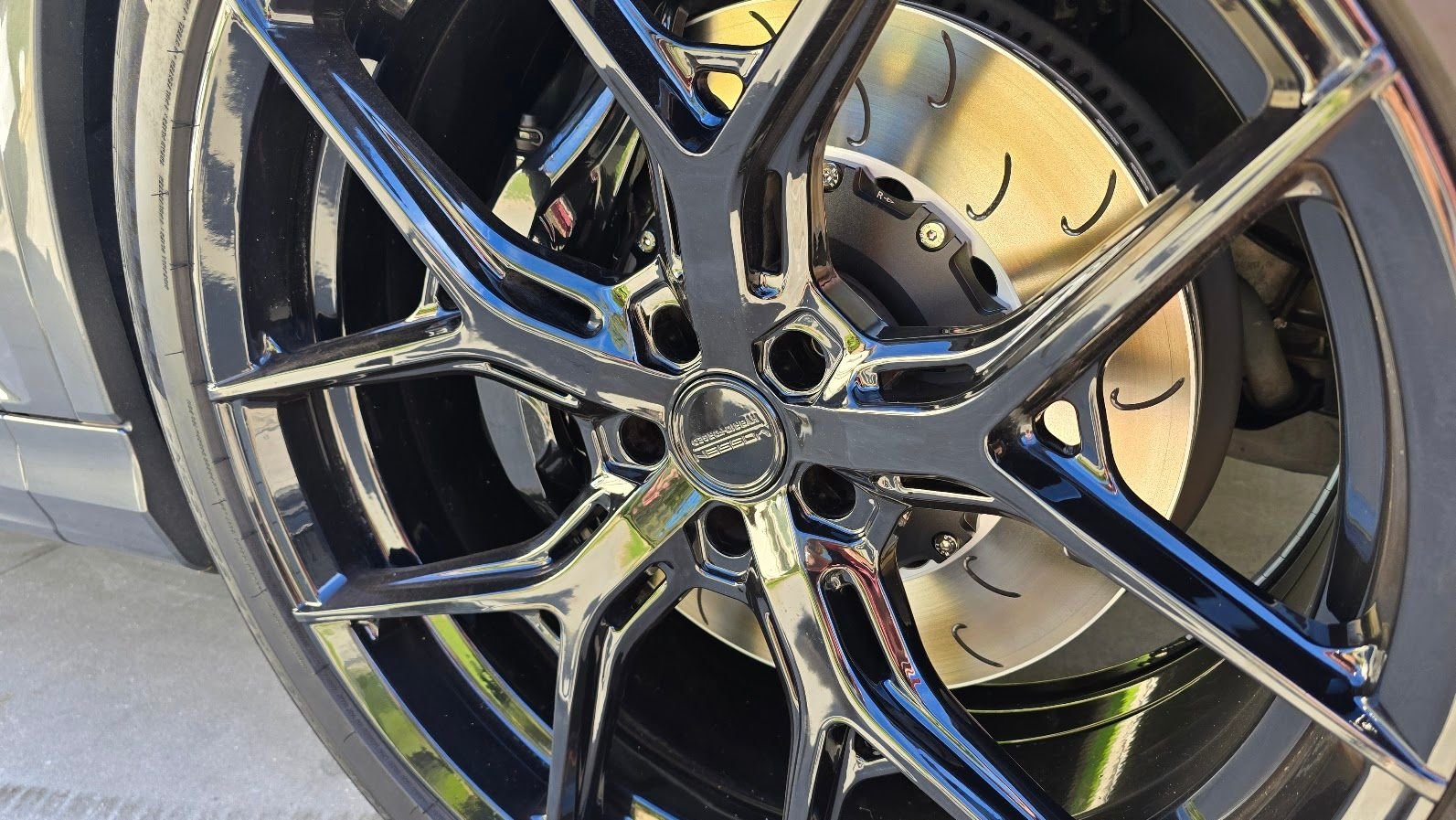

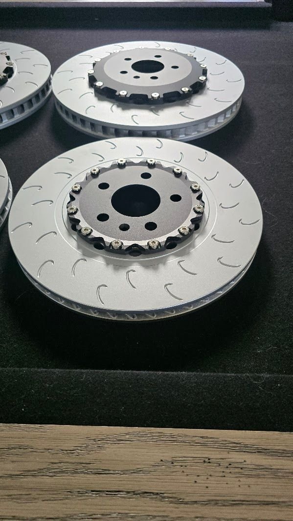

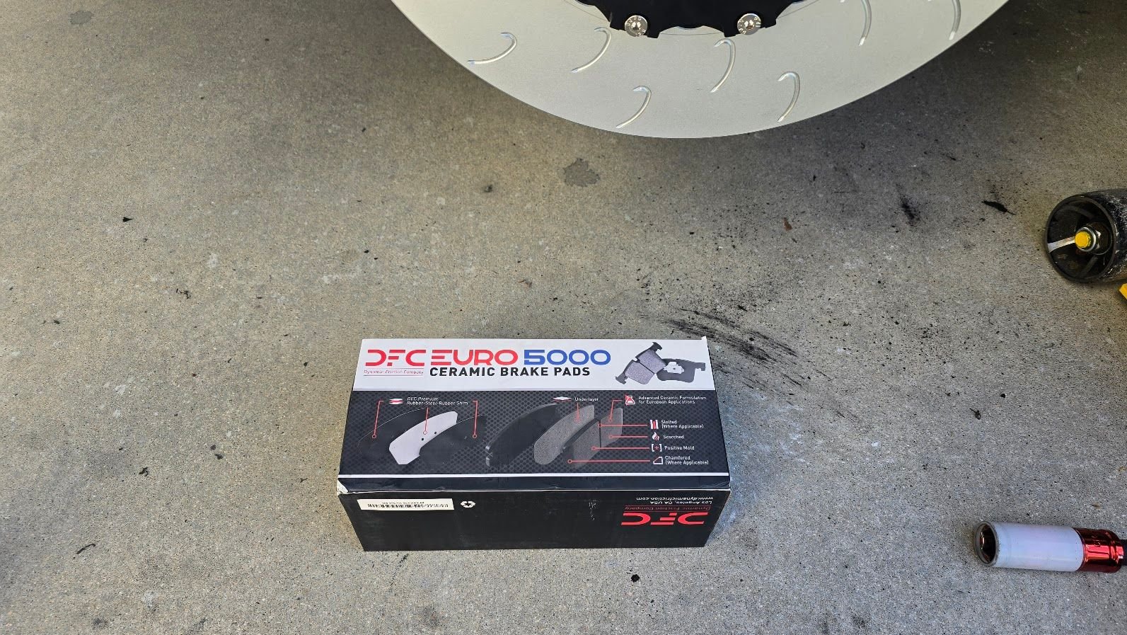

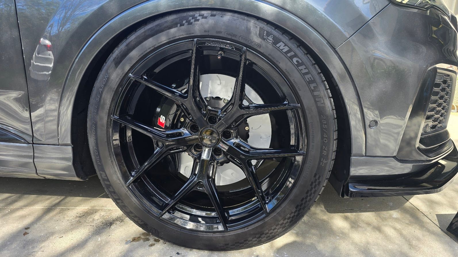

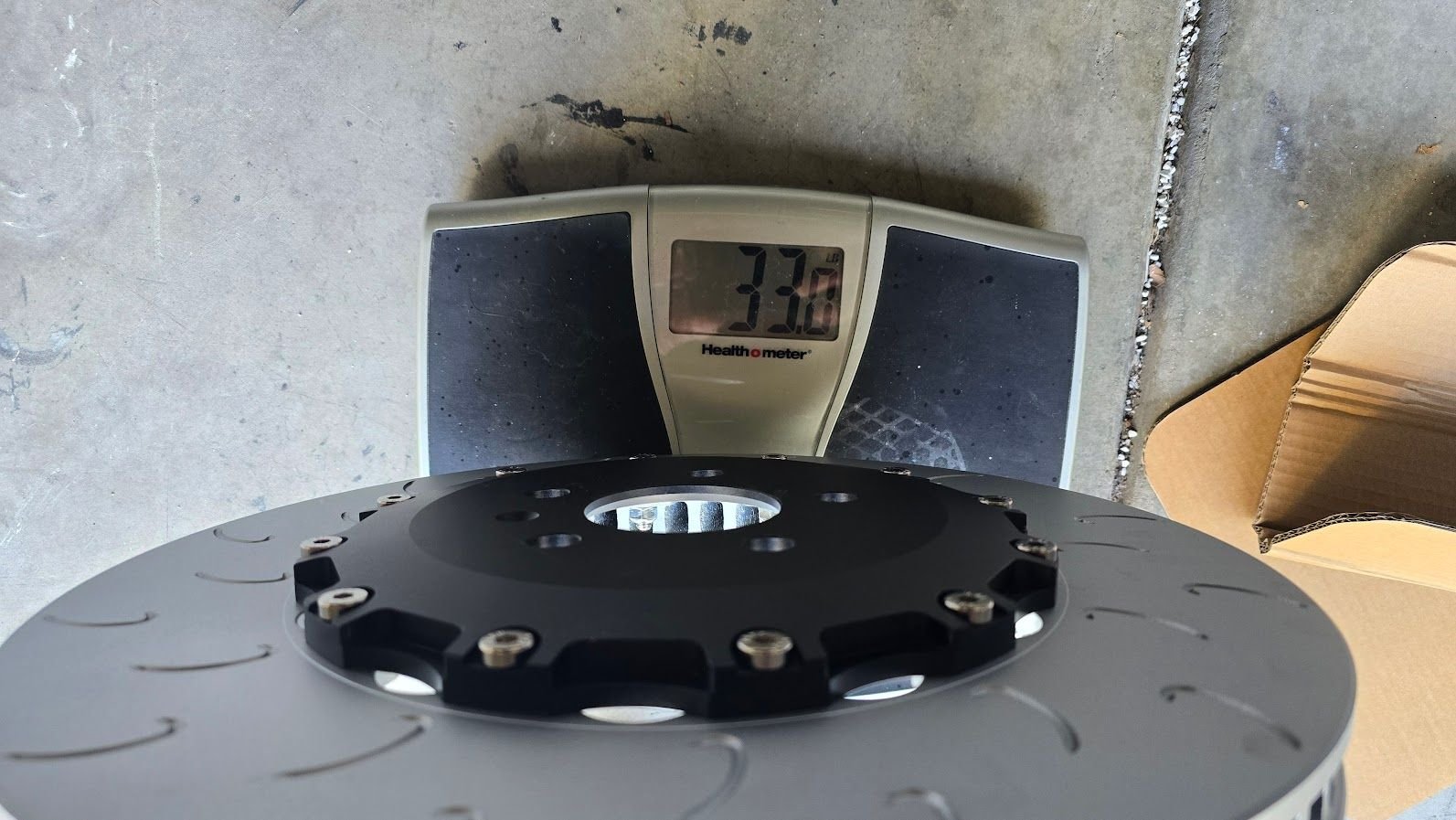

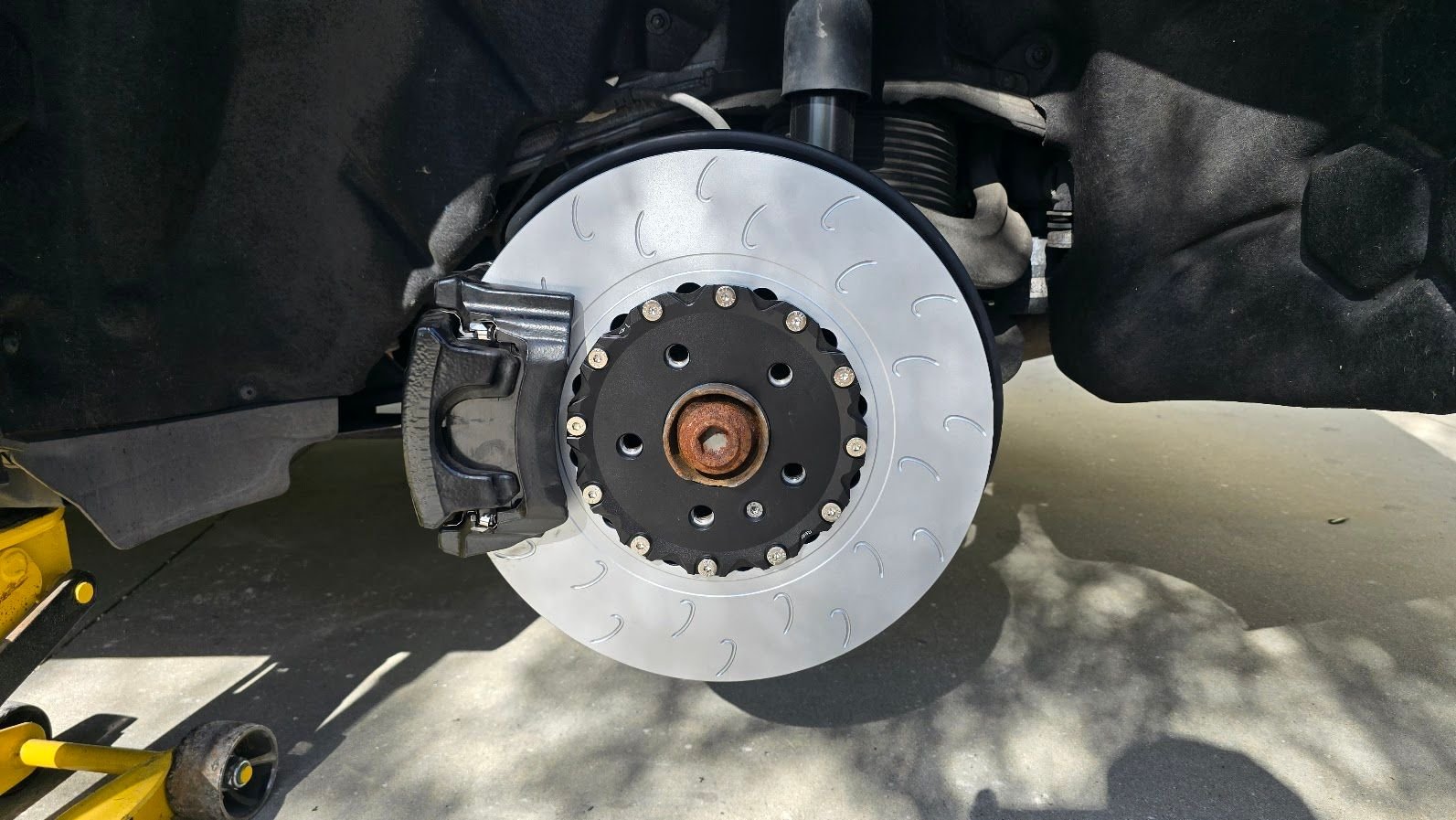

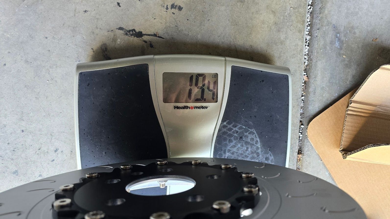

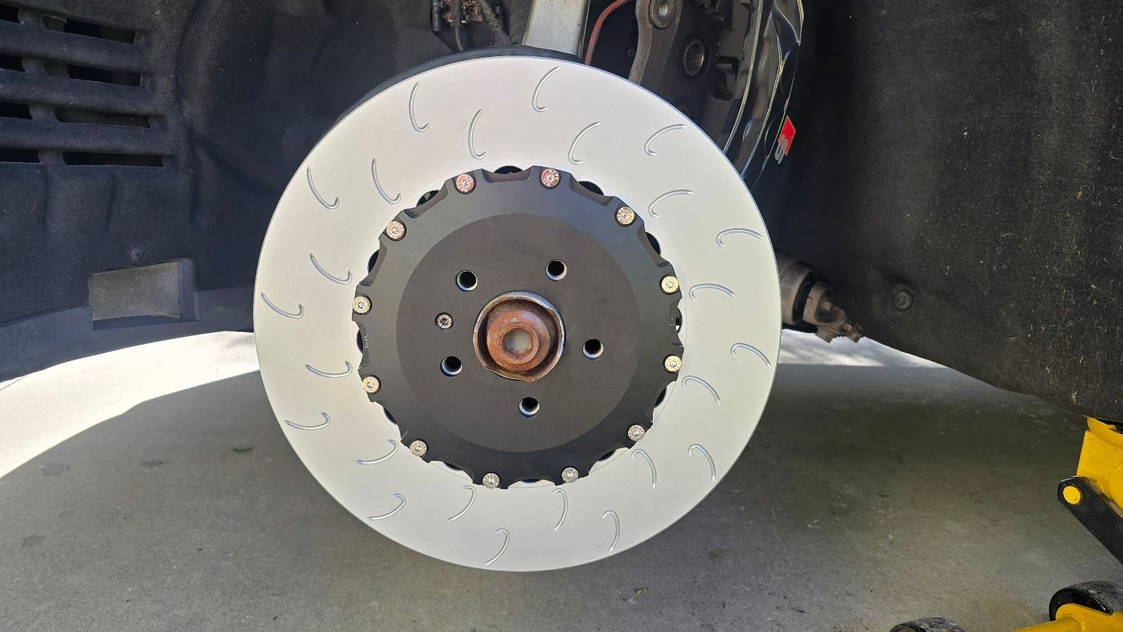

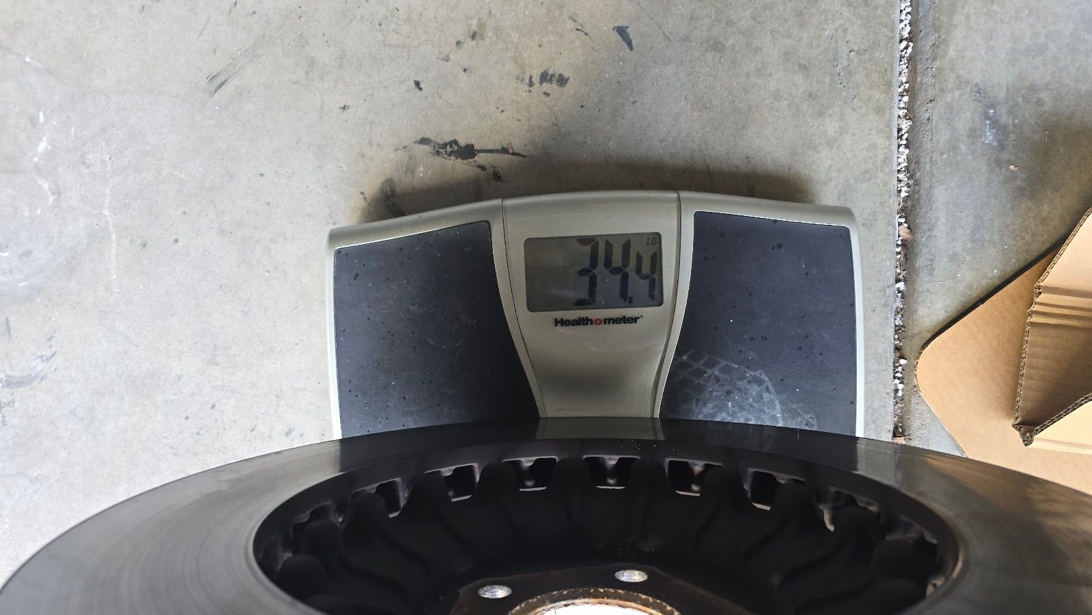

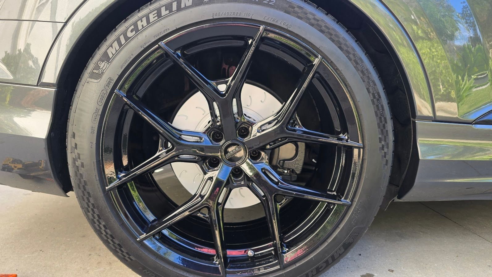

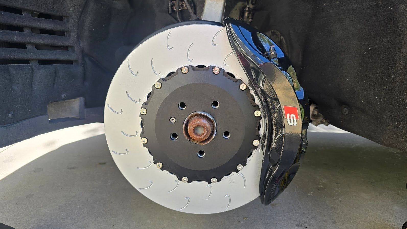

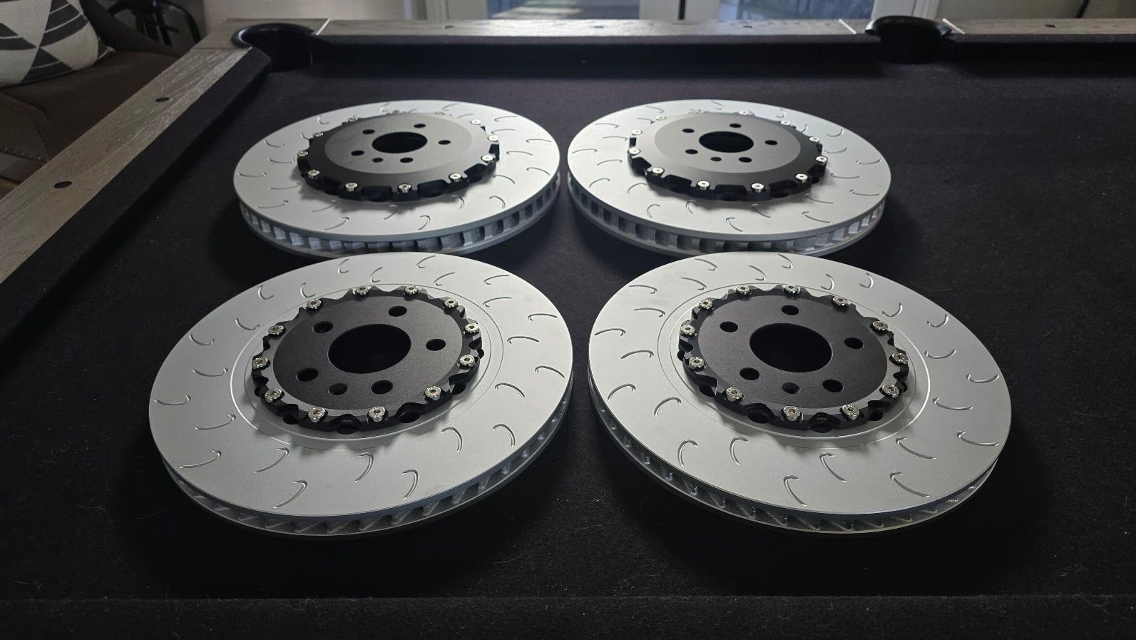

I had been really sick of how much brake dust the OE pads produce so when it came time to replace the pads, I was not going with OE pads. When checking the pads, I noticed that my rotors had a little lip on them. I probably could have gotten away with just replacing the pads, but decided to go ahead and replace the pads and rotors at the same time. Now that I had decided to replace everything, the sticker shock came when looking for rotors. The OE rotors are about $2000 for front a rear rotors (from FCP Euro) and the aftermarket options are about the same. 034 motorsports are about $2500 for front and rear and Triton Motorsports are about $2000. So I kept looking and found a vendor on Alibaba who had great reviews and the product looks very similar to the Triton rotors. I don't know where Triton sources their rotors and am not in any way saying the rotors I purchased are the same. I can say with 100% certainly the rotors I received are NOT the same as the 034 motorsport rotors. The 034 rotors are lighter and have a spring clip design, where as the Alibaba rotors have a bolt on application and only weigh about 1.4 lbs less than the OE.
So, for a little under $1,300 delivered from China and RockAuto for front and rear rotors and Dynamic Friction Euro 5000 pads, I was able to replace everything. I have only bedded the pads and driven two days locally (no spirited driving) I can say the pads already have very little dust. As far as I can tell, the only "dust" on my wheels is from the coating being rubbed off the rotors. Another very positive note is that the modulation of the brakes feels much better. The OE brakes (likely the pads) were very on/off. They were difficult to drive smoothly. They would bite at the last minute when rolling to a stop and were not smooth at all at low speeds. They were fine at higher speeds and performed well overall, but just very little modulation at low speeds. That is gone. They have bite when needed but have not issue rolling to a smooth stop and modulating the brakes at low speeds.

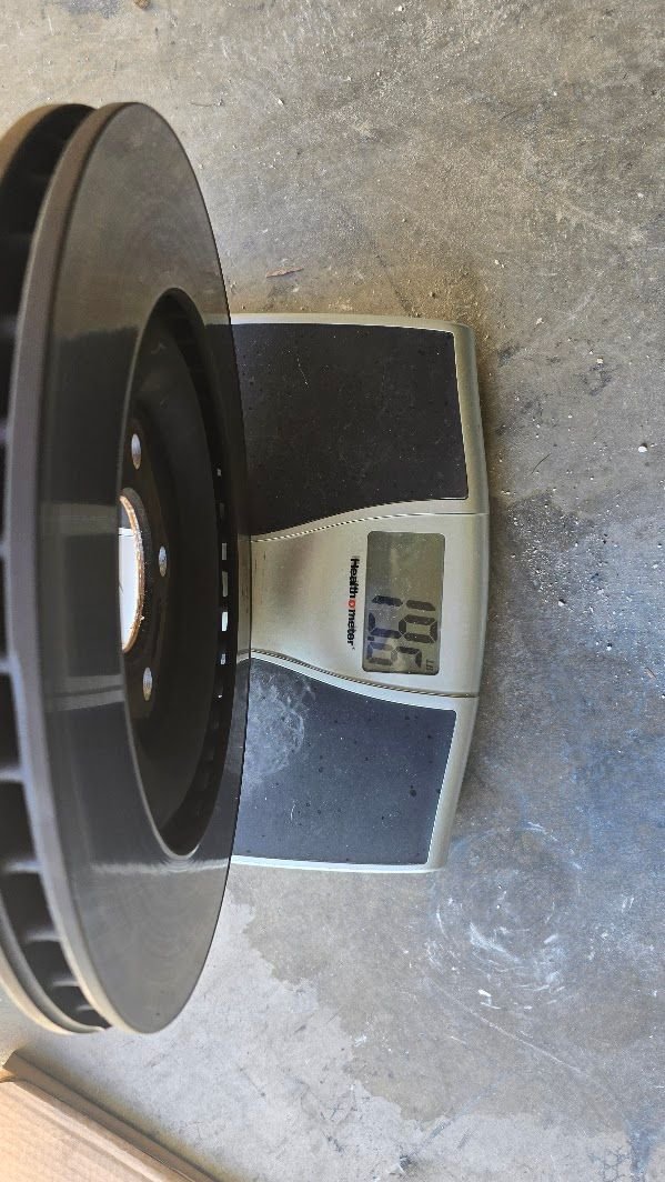

As for weight savings, as mentioned the fronts weigh 33 lbs even and the rears are 19.4 lbs, compared to the OE of 34.4 front and 19.6 rear. So they do shave a little weight, but probably not worth it to do just for the weight savings.

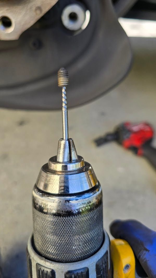

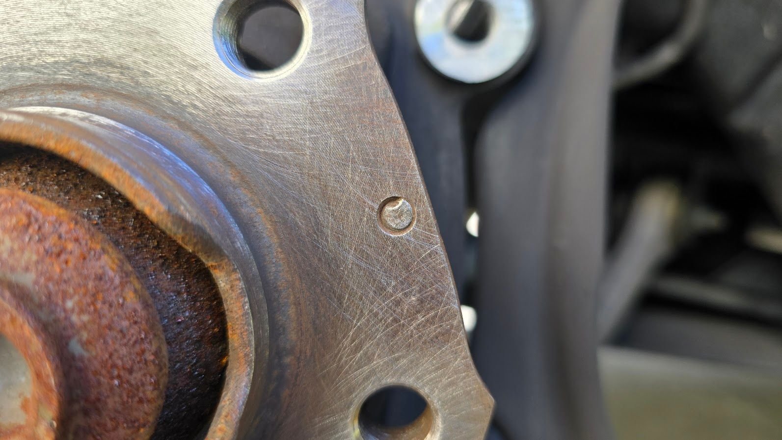

As a side note, my car was pre-owned and purchased from the original dealer who sold it. All service was done at the dealership, but for some reason one of the rotor retention screws was broken off and not replaced by the dealer. So, I had to extract it myself and get a replacement.
Lastly, the OE wear sensors are stupid expensive. $140 for the front and $99 for the rear. Ya, no thanks. The front was re-usable but the rear broke apart when trying to place it on the new pad so I ordered one from FCP Euro for $20 bucks.
Time will tell on the overall performance of the brake pads and if the dust really is a lot less, but for now I am a happy camper! And they look great too!

Hsingyik Dongying Xingyi Global Trading Co., Ltd. is the seller and here is the link: Audi SQ7 Rotors

- Most OE pads suck and most enthusiasts seek better pads with better bite, better fade resistance and often less dust. They are disposables, if the Dynamic Friction pads don't exceed my expectations on bite, fade and stopping power, I will toss them in the bin and look for something better. Only thing I know is that the OE pads had terrible modulation at low speeds and were insanely dusty. Did I ever experience fade, no. But I also don't track my SQ7, so that is not a huge worry of mine.

As for pads, I have always been a fan of EBC and if it were not for the positive reviews of the Dynamic Friction 5000 from forum members (specifically on the SQ7) I would have used the Orangestuff pads. So far, I am very impressed with the DFC pads, I just have not had a chance to run them on Ortega Highway or Angeles Crest (on my way to Mammoth) yet to see if there is any fade with repeated braking.

This from 034 is what sold me on their rotors (especially having to wait a number of years before there were any options other than stock):
The central hat portion of the 034Motorsport rotor is made of 6061-T6 aircraft specification aluminum. The disc is constructed out of a proprietary metal alloy that can withstand immense braking temperatures while holding form. From the factory, the same rotor is used on both sides of 4M/4M.5 SQ7/SQ8, leading to one side having incorrect venting and cooling effects. The 034Motorsport 2-Piece Floating Front Brake Rotor Upgrade Kit utilizes 72 directionally curved vanes properly oriented for each side of the vehicle to forcefully flow cool air through both rotors to dissipate heat equally.
The face of the 034Motorsport 2-Piece Floating Front Brake Rotor Upgrade Kit utilizes J-Slot slots to clean the pad and surface of contaminants and allows hot pad outgassing, all while reducing overall braking noise compared to a traditional slotted rotor.
The 034Motorsport rotor and hat floating mount system utilizes high strength alloy steel bobbins. The pins take the load from braking actions while maintaining the axial and radial float between the hat and disc, allowing for safe expansion and contraction from heat.

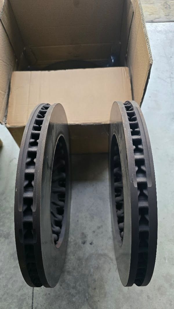

Ouch, the statement I highlighted above actually makes me lose some trust in 034.
​​​​​​"From the factory, the same rotor is used on both sides of 4M/4M.5 SQ7/SQ8, leading to one side having incorrect venting and cooling effects."
This is simply incorrect and misleading. There are two separate part numbers for the OE: 4M0615302K (R) and 4M0615301BM (L). They are 100% directional, with proper directional venting on both sides
The OE rotors are actually quite well designed. I am not sure why 034 would make a statement like that when anyone doing this job themselves could see that it's just false. They cold have simple said "The 034Motorsport 2-Piece Floating Front Brake Rotor Upgrade Kit utilizes 72 directionally curved vanes properly oriented for each side of the vehicle to forcefully flow cool air through both rotors to dissipate heat equally." and said nothing about the OE rotors and been fine. Just my 2c but that is disappointing.
