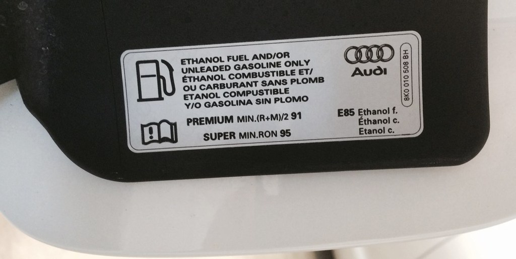

Originally Posted by Sonko2010
I am curious what your thoughts are on using the 91 octane gas here in CA given the gas cap recommends much higher.
Chris, the gas cap recommendations are for 91 octane by USA standards. Is it different for a 2004MY car?
Our cars all show 91 octane or better. Printed Owner's Manuals show the same.
